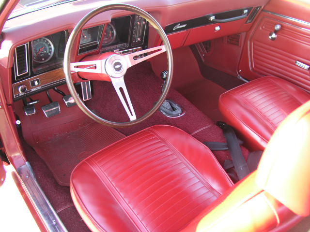

Anyone have some input on the color of the top metal of the dashboard as in did a red 69 camaro have a red dashboard with the red dash-pad or was it black dashboard with the red dash-pad. Maybe they painted the dashboards the same as the dash pad color black/black red/red blue/blue green/green and along with interior color you would think if you did not have a red, blue or green interior you got a black dashboard and a black dash-pad. If so would this color on the dashboard correspond the same for the ashtray and glove-box area.

A '69 with a red interior would have had a red dashpad. The lower part of the dash including the glove box and ash tray doors would be painted semi-gloss red on a standard interior car; custom interior cars had the faux woodgrain. The upper dash area would also be red but with a 'suede' flattener added to the paint to reduce glare. Suede sort of resembles the 'wrinkle' finish often seen on small toolboxes; flat or semi-gloss is not correct.
One inconsistent area was the finish on the VIN plate for cars with non-black dash tops. Sometimes they match the dash; sometimes they were left black.
