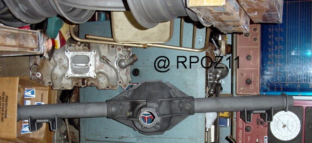

On my 12-bolt, I have C XX 1030 G1
---------------------------->E<---------------------------
What does the "E" designate? The "E" is right under the 3 of the 1030
Thanx!

E = Eaton

E is a positraction code. E refers to Eaton positraction differential.

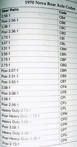

Old 05-17-2005, 07:16 AM
WILMASBOYL78's Avatar
WILMASBOYL78 WILMASBOYL78 is online now
Location: new york
Posts: 8,422
Thanked 2,301 Times in 612 Posts
Default Re: 12-Bolt Axle numbers stamping inquiry
"C" is the first of three letters that designate the axle ratio code that applies to a specific model and year. The three letter code started witht the 70 model year. EG: CBT = 1970 Nova 3.55 posi. Colvin's book has a complete listing of the codes.
