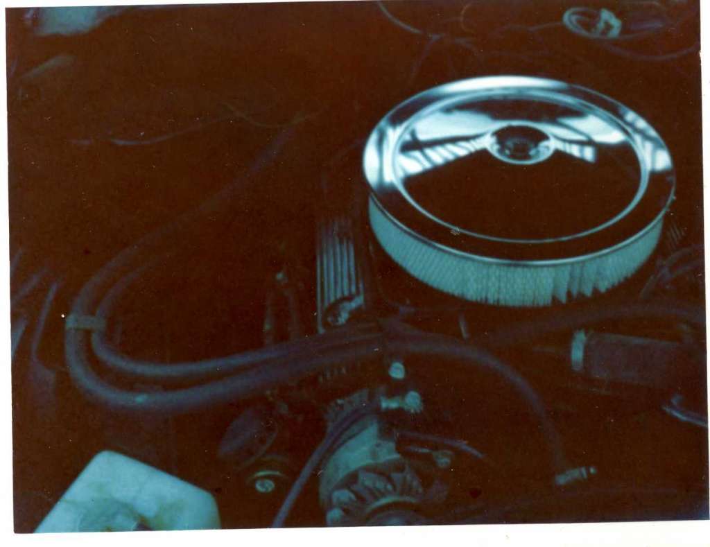

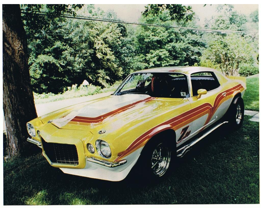

Is it true, or is there at least some evidence, that a T in the 5th position of the VIN# on a 1973 Camaro indicates a true Z28?
