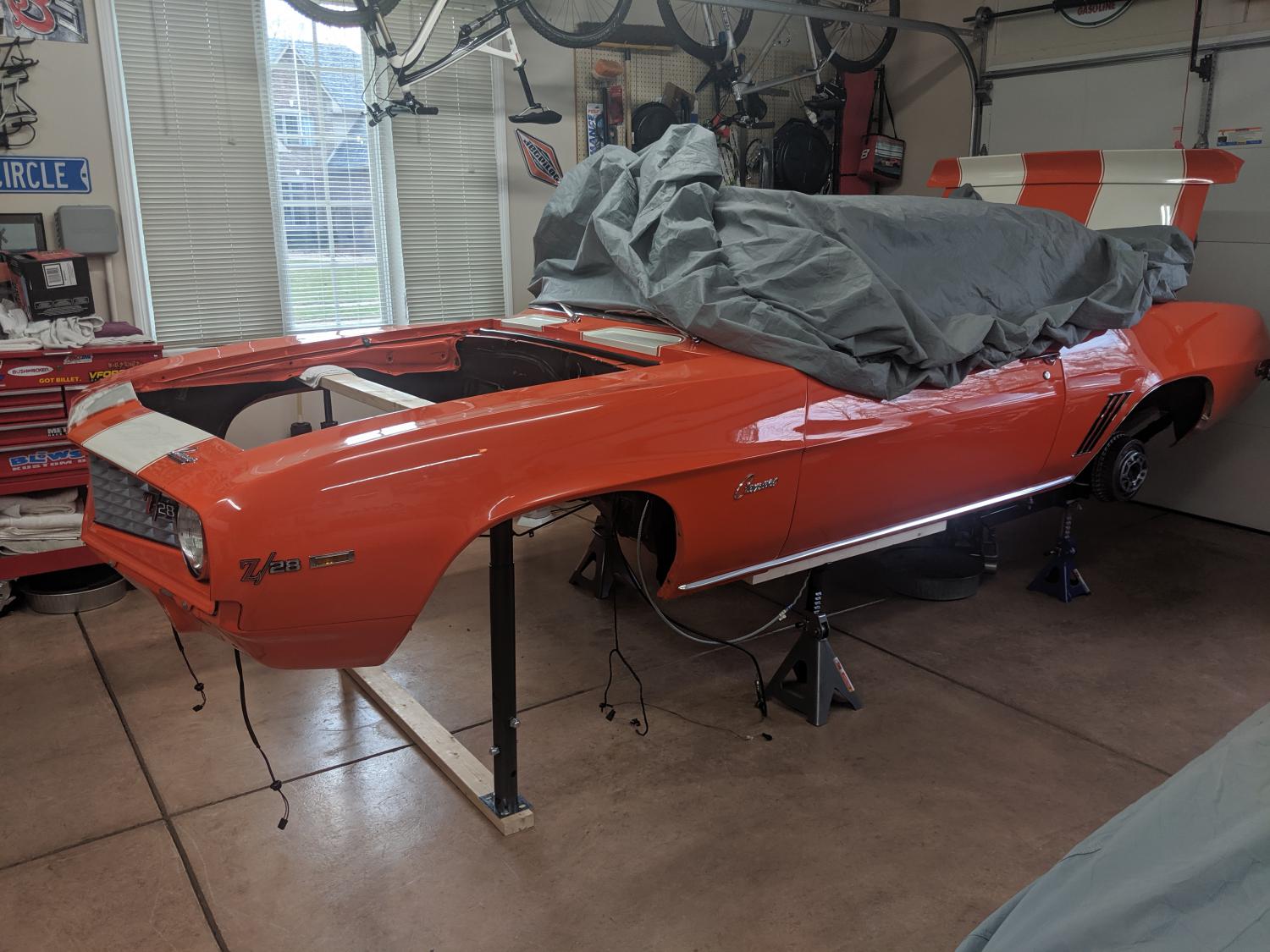

I didn't see what he used to support the front clip, other than the fender bolts. I would fab up tubular structures to sit on the floor and support the front of the fenders to hold that weight, as the front will sag with only the fender bolts to hold it. Don't open a door after sub frame removal, or you risk scraping the leading edge on the fender.

It's no problem the front sheet metal will support it, I did support the core support for insurance. I did use this as support when I removed the core support.
