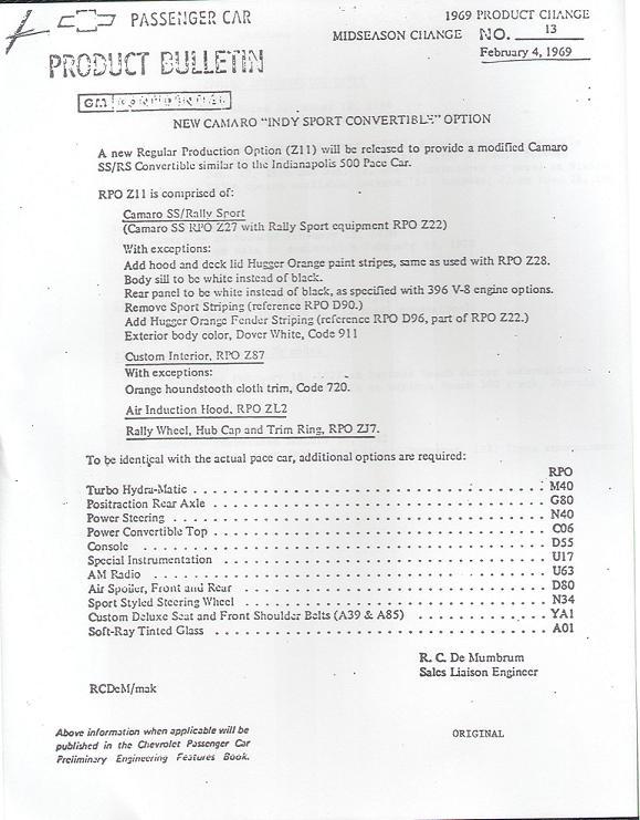

I need this information and know no other place with more informed people so here goes. I own a decent 69 396/325 mn car and presently concidering a new project. I have found a 69 bb pace car that does not have a engine. I have a couple 69 referance books but can not find out what engines came in the bb cars. Were all(325,350,375 hp)three offered? Just curious. This will not be a concours type restro but I like to keep it as close as possible.

Pace Cars had the same bb engine availability as any Camaro SS. The most common would be the L35 325hp (19.3% of SS) L34 350hp is the rarest (5.8%) and the L78 (14%). 311 L78s also had L89 aluminum heads.
If your car has dual fuel lines or A/C it could not have had an L78 engine.
A popular Camaro fairy tale is that only 34 Z11s had 396 engines. 39% of Camaro SS had 396 engines. Allowing for a wide margin for error certainly 1,000 Z11s or more had 396 engines.

February 4'th, 1969
RPOZ11 to be comprised of:
"Exterior body color, Dover White, Code 911"
Really!??
Where did they get that # from; an earlier Camaro or Corvette??

From that dot.org Camaro site this bulletin is in;
"Shortly after the Z11 was produced there was also a special run of '69 Camaros called the Z10, which is believed to be a regional promotional item for certain southwestern and mid-western states"
I do recall a friend here locally who had copies of pictures from the press releases showing the Z10's actually at Indy!

Check out the CRG chart. The Dover white color numbers all relate to each other across the board
Window Sticker RPO Code
Body Color 1967 1968 1969
A or 10 5900AA 5900AA 5910AA
B or 69 -- -- 5912BB
C or 50 5900CC 5900CC 5911CC

I got the vin on the car.124679N618023.Plate shows it to be a Z-11 built 03D. Present owner said it was a 325hp car.Had a muncie but it is gone too.The paint code is 50A though not 911. It is nothing special but would make good driver. Thanks again for the help.

Hhmmmm...Mine is a VN "L52xxxx" 03B build and a 325/396 #'s car with a Muncie. Interesting how close/far apart the numbers are between plants.... As for Mr. Hawaiian Camaro, I dont keep specific records on the relative paint coincidences but what is odd to me is that the "911" code was in that 1969 Document...
