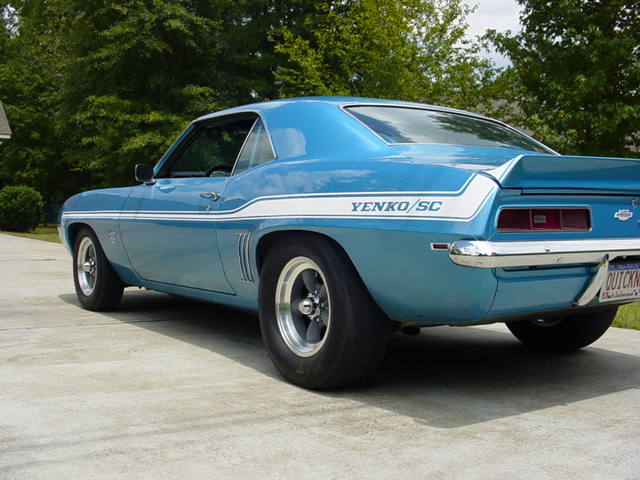

Thanks in advance for your help. Hope to have my Yenko Clone on the road at the first of next year powered by a 496 stroker in place of a 427.
