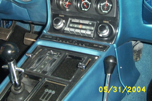

Here is a picture of the lever on a car I looked at earlier this year.
James
1968 Beaumont SD396

OK, I sort of thought that is what you meant
David
