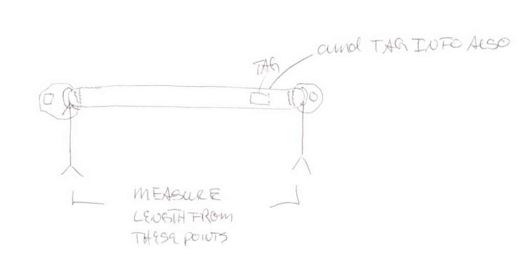

I need some help from anyone that for sure has a original set of belts in there '67 and "does not have belt retractor option" on the outside fronts, I will attach a pic of the measurement i am looking for any help would be great,
I want to send my belts off next week for new webbing and would like to confirm what is correct, I have what appears to be back seat belts in the front??? or they may be correct just want to make sure before sending them off.
Thnx Bud

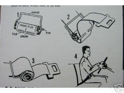

That is the Million dollar question,
My car is a 11B-November 66 car and have been told early cars did not have retractors??, and at the dealer you could purchase the chrome Doo-Hicky Winder up holder for the belt so it would not be just thrown on the floor, here is the unit, I cant seem to get a clear answer for sure if they really never had retractors??????
Thnx for the feedback, Bud.

Guess what. Mine 67 RS doesn't have retractors... and yes it has the chrome doohicky. I am 100% sure they are the original belts.

My belts have this cover on the end where it mounts to the car, its like a rubberized sleave that covers the bolt. I couldn't get an accurate measurement with the chrome retractor doohicky and my belts are kind of ravled so I don't really want to take the doohicky off, but it is approximately 19-1/2 inches from the points you show and 20-1/2 inches from the mount point at the top to the bottom end.
If you need a more accurate measurement and pics, let me know.

ok,Jeff what is your build date??? looks like your belts were built Mid November, what is the model number on them, are they by chance "Model-120" and are they Hammills??? or???
and if you could post a couple pics with the belt retracted and pulled out I would appreciate it, also does the rubber cover look like the one used on the '69 inside front belts, it covers the mounting bolts,maybe a pic of that critter also, This is the first I have heard of the bolt cover on a '67 you really have my attention now!
Also I looked in Ricks Catalog and it shows the chrome retractors and a mention of its use on early cars, the next question where is the break in early cars??? and later cars with the plastic retractors???.

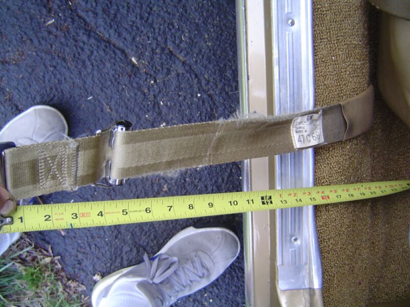

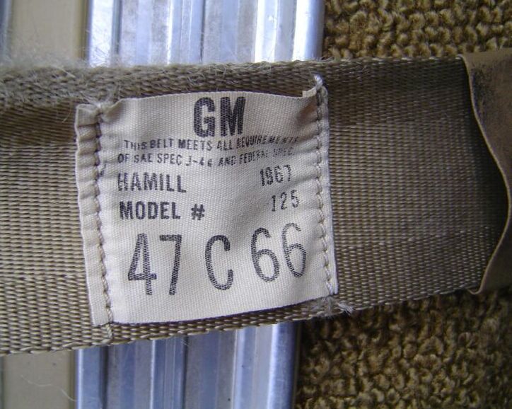

Front belts:
Hamill 1967
Model # 125
47 C 66
Rear belts (2):
Hamill 1967
Model # 122
42 C 66
All belts deluxe with no retractors
Front dimension extended, confirmed 19 inches exactly.

close up of tag

Jeff, thnx I have a call into a relative that is not a car person but has a 11B RS/SS 350 car in a barn on there property, they going to look at it and let me know how it is equiped?? I hope??
The guy who just did my tages checked his records and he new of three orig cars with deluxe belts but there Model # was 120, Not 125 like yours???
