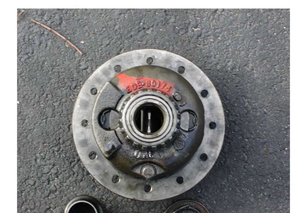

Is there a correct part number for the posi unit on BE axles? I have read somewhere that the unit was machined different, different guts, and such...What posi unit is correct for a BE...

The BE rear end had special part numbers for the ring and pinion set, but they all used an Eaton 4 Series Posi carrier. The part number cast into the end of the unit is EDB 30174.

The guts were completely different. The side gears were unique and the spider gears were bigger in size like the non posi spider gears. I had one rebuilt years ago and the rearend guy said in the 20 plus years he had been doing them he had only seen one other. Somewhere I have pics of the gears.

The posi carrier in a "BE" rear is actually a #234 and is different then the standard #174 4-series carrier.

Not that I'm any great expert, but I was quoting Ed Cunneen's book, page 85, where he states "This 4.10 positraction axle consisted of a special service Eaton positraction case (ED8-30174)including heavy duty springs, spider gears and plates..."
If GM used other carriers, where would I find the information?

To answer your question.Pick up a copy of "Chevrolet Special Equipment" catalog.
This is filed with Hi-po parts Chevrolet sold then & now over the counter.I have one here dated 3-9-72.It shows a 4:10 Posi Ring & Pinion Part#3917971 for all Chevy cars.
Carrier#3918837 replaced #3916234.

The Spring plates and springs were also COPO specific and different than a standerd 4 series. Just like Clill said.

OK, I guess I have the correct unit. Are these date coded anywhere? And, Do I understand that these may have been available over the counter??? Im trying to determine that this unit actually came out of my axle I have....

Interior shot of the plates and springs...
