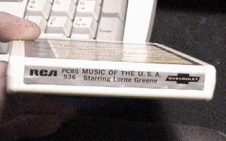

Yes,you could and did receive the demo tape with it.Talk about a mess of wires with the two options combined .The demo tape is called "Music of the USA,featuring Lorne Green". Very hard to find cartridge.I have a few 8-trks and the multiplex's for them.The 8-trk multiplex has an additional jumper that the std. unit does not have.The 8-trk / multiplex combo uses # 7305221 and multiplex alone uses #7304621.Multiplex to radio uses a 9 pin plug,8-trk to multiplex is an 11 pin.The multiplex/8-trk has the same two plugs,9 & 11 pin.....

Old 02-20-2004, 03:12 AM
68l30's Avatar
68l30 68l30 is offline
Join Date: Sep 2000
Posts: 3,350
Thanks: 60
Thanked 91 Times in 43 Posts
Default Re: 1968 Camaro Console Multiplex option
Tape picture.......
Steve

Do you have the Original Slide box & papers that 8tk Tape came new in?
There was an earlier 8Tk tape issued before that one,that is a completelty different design released in 1967-8.
I have all these from Chevrolet,& I would think the earlier version would have been available in 68..thoughts?
I Have seen that one in your picture in 1969-70 Chevrolet Cars as well.

I have another in my Camaro with a sleeve.It is different than the one pictured...I wish I could get to it.. I felt this one was correct for my car,it is one of the last 68's built...
