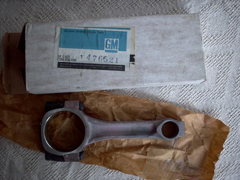

Need application for GM PN 1476521 (# on the box). Supposed to be HP 302 rods. I imagine this is a superceded #, but I don't have any reference sources for the part.

do they have a bushing in the pin end ,,i think they will fit any small block,the piston deck height will compensate for the difference in stroke,,i have some numbers il check them out and let you know forsure

Thanks for checking. Here's a pic to check out.

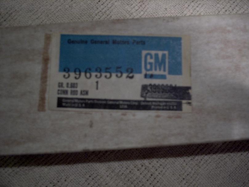

If you carefully remove that top sticker, you should be able to see the original number on the one below. It might give us more info...

Good call, Ed . The sticker came off easily - shows 3963552 and in the blacked over area - 3969804.

From the 1969 HD parts list in P&A-30A
3969804 - 396/427 ROD ASSY., Conn. (floating pin) (7/16" bolts)
Has this note associated with it:
This part can be used inplace of 3909846, provided the rod cap clearances are machined into the cylinder block
The 3909846 p/n is the floating pin, 3/8" bolt, rod for a 396/427 identified as 1st design.

3963552 shows as 1970/454 ENG in my 67-72 Camaro Factory Parts Catalogue.
