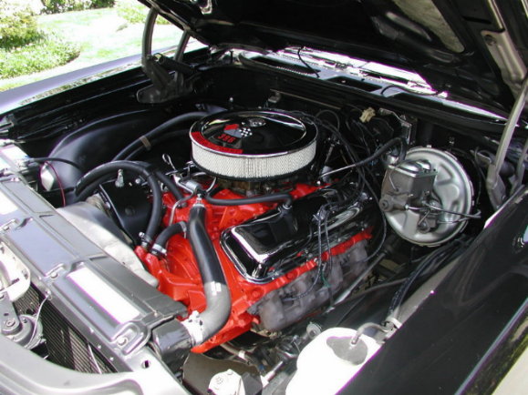

No that would not be me. I am Myles. Thanks for the welcome! Here is a picture not that clear but you can get the idea. Not a Super Car but it's baby brother with a 396.
