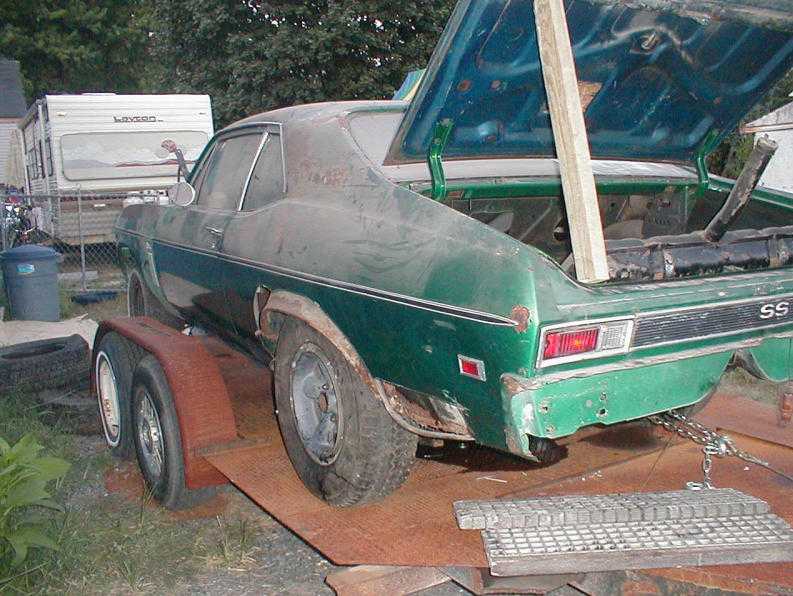

For my R.Green car, the hardest part was finding an area on the car that still had some of the original paint. A prior paint job had been done on the car, including jambs, etc.. So, I pulled a fender and hacked out a piece of the cowl, got it scanned, and will then weld it back in. It can be a lot of work, but I want the paint to match what was put on the car back in '69, at that Nova plant, on that day!
Pic is before I bought the car, notice the replaced trunk lid - normally an excellent spot for a prophet!
