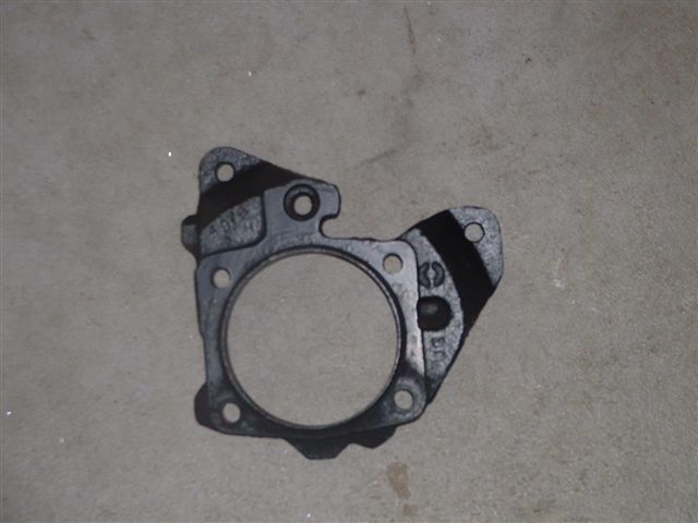

searched the web pretty good but can't find pics. I may have stumbled onto a set of JL8 brackets but they are also might be second gen firebird. thanx for any leads. DAVE

factory installed JL8 rear disc brake caliper brackets are the same as 65-82 corvette rear caliper brackets (They used 2 of the same side, I forget which side, and flipped it around on the other side). So if you need to see a pic just look it up in an on line corvette parts catalouge.

Heres a rear Corvette right side caliper mount PIC. They used 2 left side brackets to clear the shocks. [img]/ubbthreads/images/graemlins/scholar.gif[/img] but the JL8 brackets will not fit the camaro or chevelle 12 bolt rear backing plate flanges that is what made them unique to the JL8 housings you have to use the backing plate flanges from the 67-72 1/2 ton C-10 and weld them over the 12 bolt flanges then shim the caliper brackets to fit the longer production 12 bolt axle because the JL8 axle is also different, then the emergency brake cable is another story.-Denny
