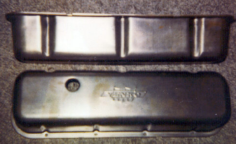

Item 2424307877 are advertised as "found in a speed shop". These covers look nothing like originals I have seen. There is a ridge stamped in those covers that all the real Yenko ones I have seen do not have. Also the tab area at the bottom of the covers are stamped unlike the real deals I have seen. If the covers are real they would of been in a Yenko box. Either with the mailing address or a brown box with a red Yenko crest. The stamped crest appears not to have the three stars either. Buyer beware on this item. If these are real, they are not at all like the literature pictures or the real ones in my collection..BKH
