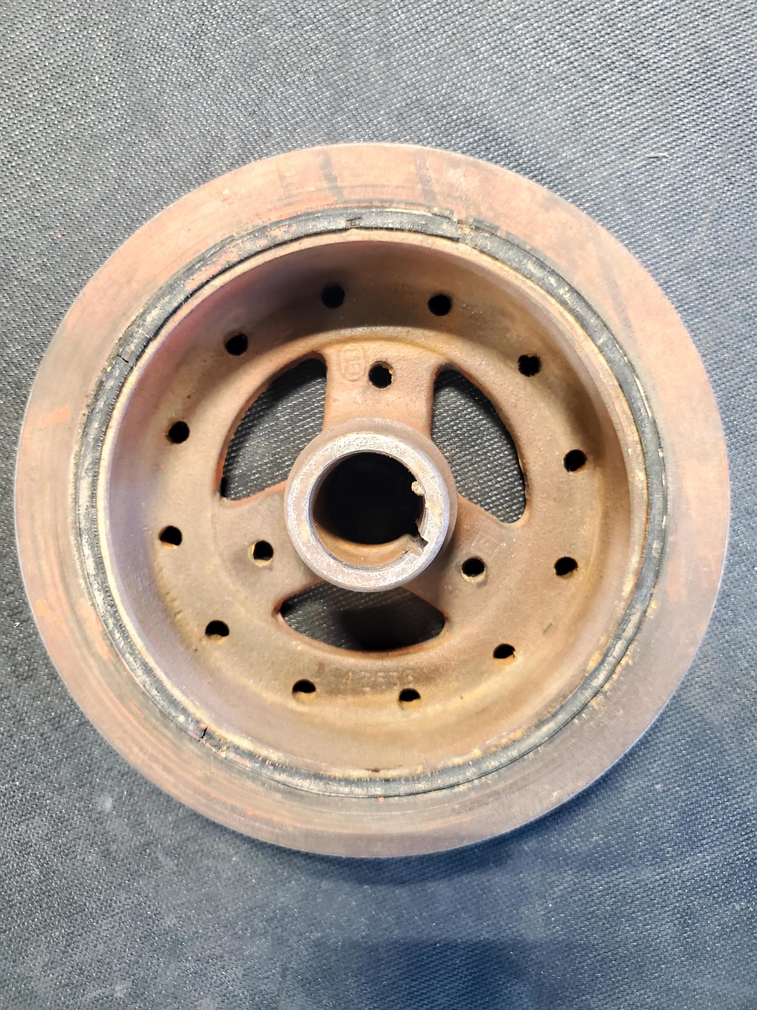

Default 7712 8" Harmonic Balancer Casting # 2942536 Dated F G 8
Dated July 68
1.75" thick
Raised center pulley mounting surface
Mike Munro
518-526-3379

It's not the same as the factory balancer on the Z28 the arms extend all the way down

would this be correct replacement for a 68 Z28

Where is the timing mark compared to the keyway?
I believe this to be a 1978 350 balancer but can’t see any reference
in the photo’s.
1968 and 69 balancers differ in the placement of the timing mark.
68’s are centered ( roughly) on the leg and 69 is just left of the leg that
Has the keyway.
Also jl8z28 is correct in that the “Windmill” should extend out to the rubber.
