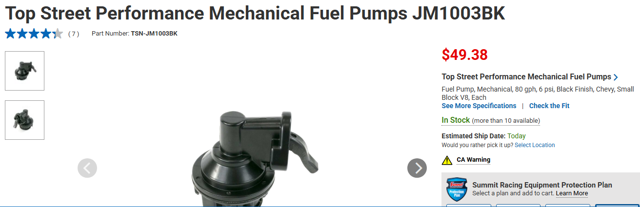

Just bought this one for my 327, haven't checked the fuel pressure so can't verify that. It seemed to solve the issue of hot starts due to overpowering the needle/seat though. It's the cheapest usable pump out there I think, but I did have to reclock it, and tap the holes, since every other hole has threads. I believe it was an 8mm/24 tap???
