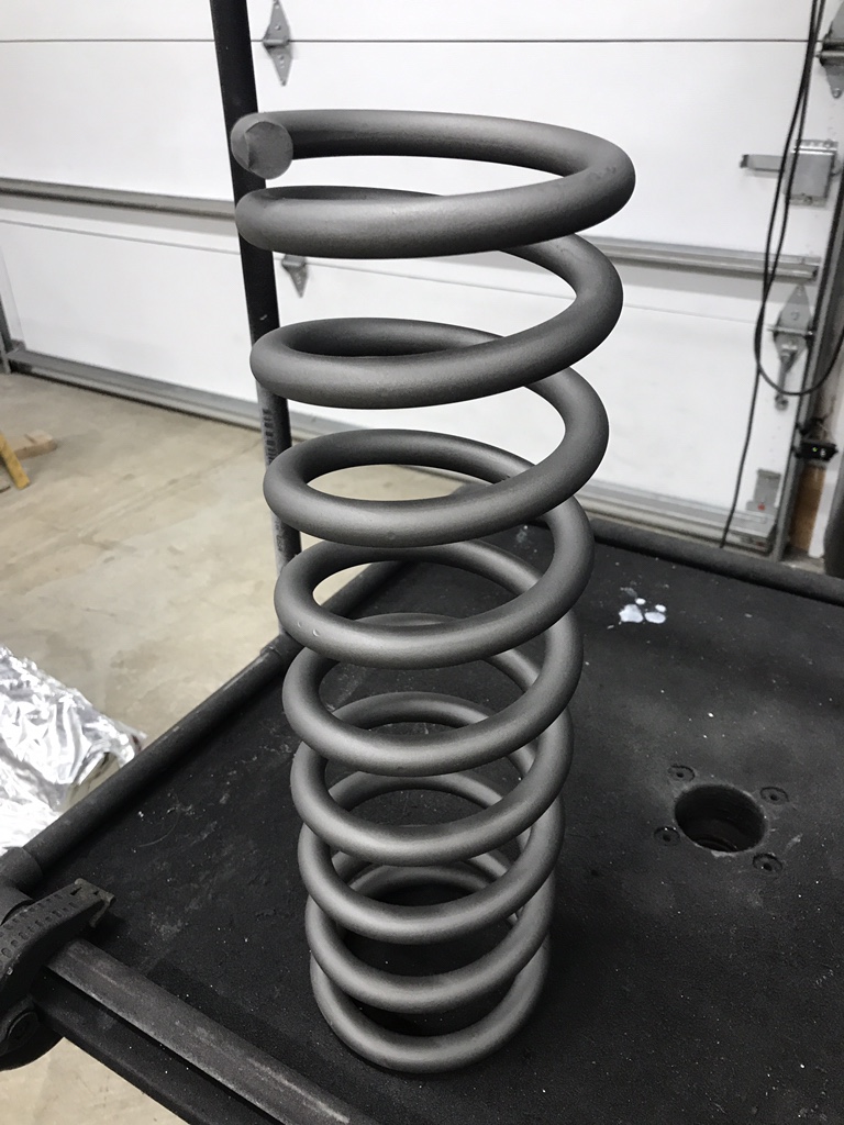

Glass beaded mine and shot with C-129 Stainless Cerakote

^^ That looks really nice.
