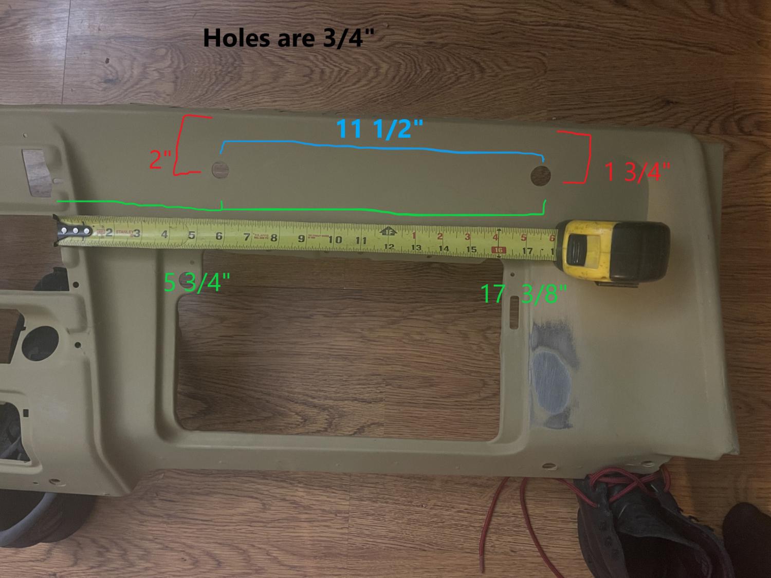

I posted this on TC with a 67 Firebird dash. It is same location on 68 Camaro.
Since dash is out of car it allowed easier measurement of holes.
Someone may need this one day. Feel free to share.
