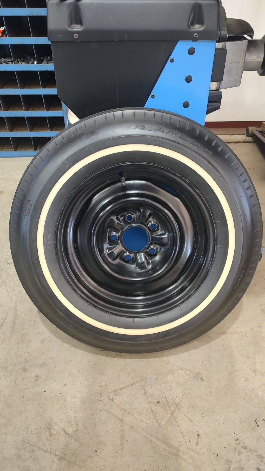

I just got back from a 10 mile ride. what a treat! Yeah, the tires are eggs and drive like crap....I can easily fix that. Next on the list, I'm going to pull the fuel tank and get a good look at the tank sticker. I'll gently clean, photograph, and get it sent off to NCRS for validation. Al Grenning is sending me the paperwork to validate the engine, trim tag, and POP.
