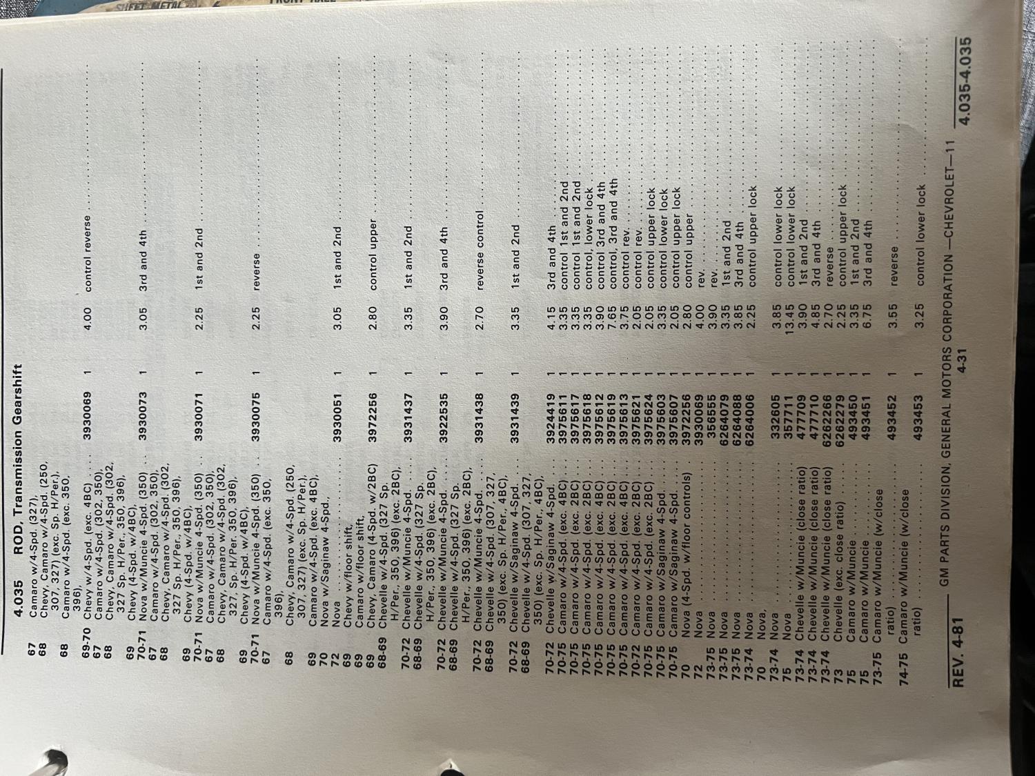

I’m trying to find the number for the SB lower rod on a Nova. The lever and upper rod were shared with the four speed. My parts books and AIM are vague. The 3sp in the AIM is a Saginaw. Anyone have better info, setup in a car or parts in the stash?

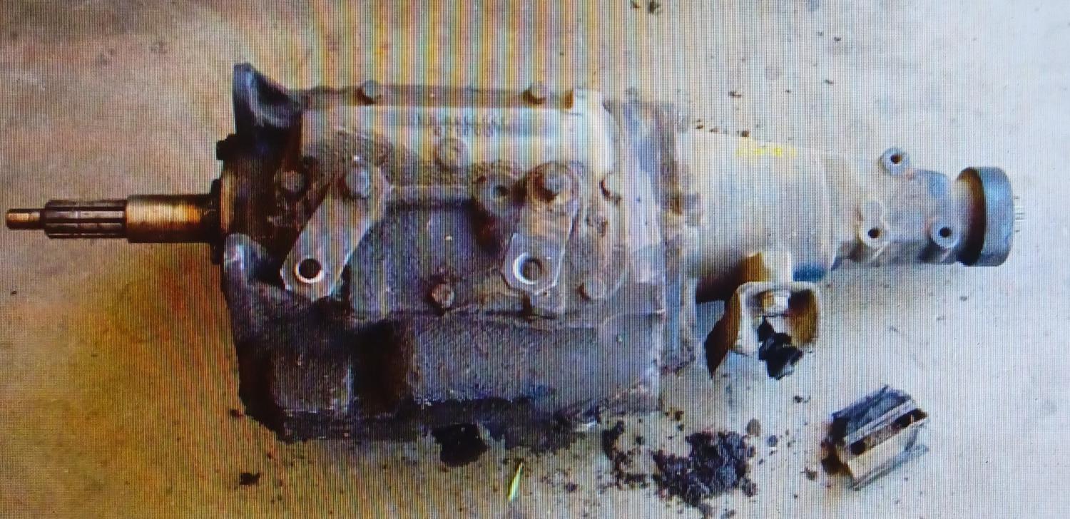

Curiosity kicked in.
Top pic is Muncie
Bottom pic is Saginaw.
First- reverse levers are in same place.
Your pics above show 1 Muncie and 1 Saginaw.
First- reverse lever shows same part number for both.
Why would the rod be different?

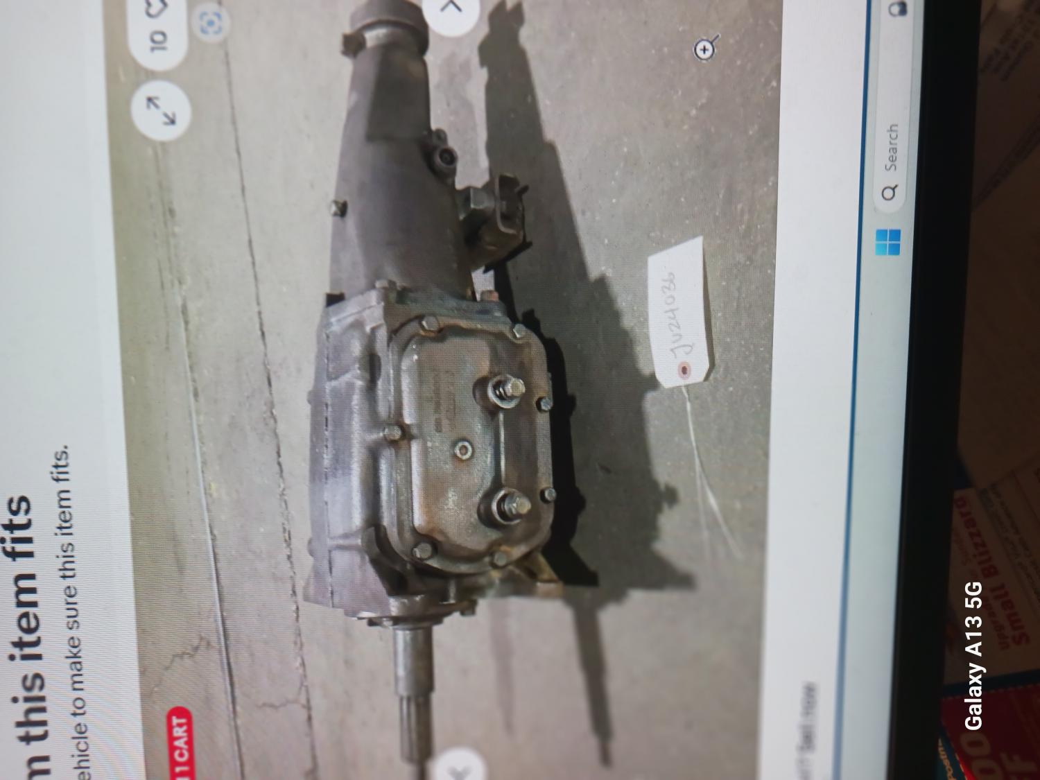

Is this the setup you are talking about? This is a 69 Saginaw 3 speed HD from a big block Chevelle.

If that is out of a 69 that is a Muncie MC1 3 speed. I don't believe a saginaw was offered for the chevelle that year either. There was a saginaw that resembled the muncie. Does the one pictured have the 5/16" two piece ball? Flat side shifter? Bench was flat buckets said muncie, I believe.

Default sure looks like a Muncie to me
Looks to be a Muncie.

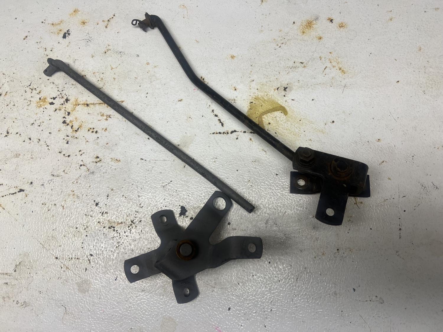

This?

See how everything is (ex HD). Also those are the shifter control rods.
