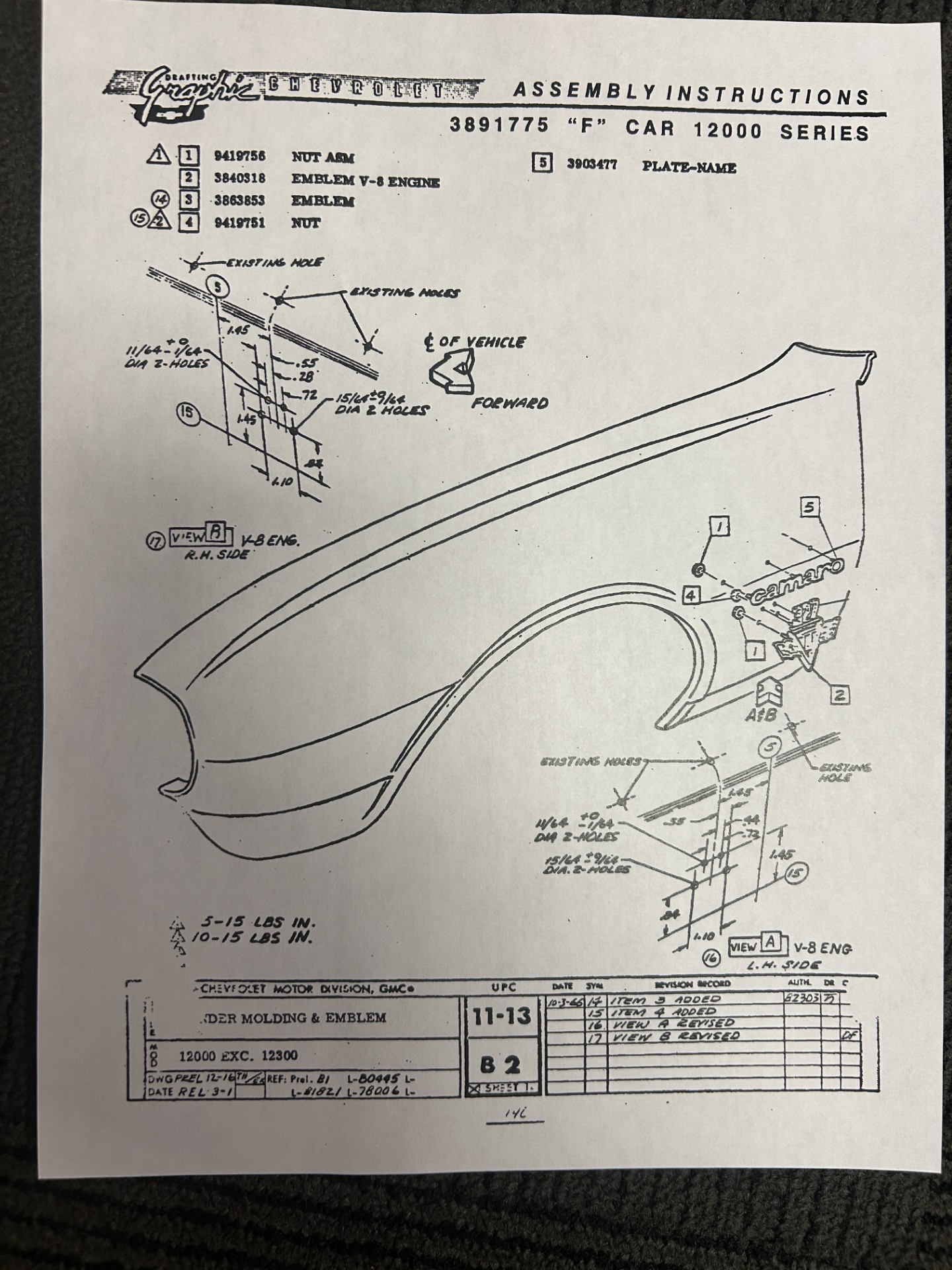

I've spent about an hour now and gave up finding the dims for placement of the V8, 350 and SS emblems on my '67 SS. I have NOS fenders and need to, accurately, locate these and I thought I had seen this in the manual, but I can't find them now. Anyone know the page(s) numbers I'm looking for ???
Thanks in advance for the guidance...

Page 146 in the AIM
UPC 11-13 Sheet B2

Here you go

NOW, anyone know what the number 15 line is that seems to be the plane I'm supposed to measure up from ? I thought it might be the body line at the bottom, but that is WAY too far down to only measure up the small dimensions on the page...
I have an idea what to do with this and it won't involve any measuring.
I have the original fenders, with all the holes and will find a way to locate them on a template to transfer to the new fenders. The left original has been smashed numerous times in the front and I don't feel confidant in using that one for locating the SS emblems on a template and the right one is 12' up a post in the back building and, of course, the post is surrounded by "stuff". I'll have to resort to doing something like all the crazy fails we watch on youtube...
