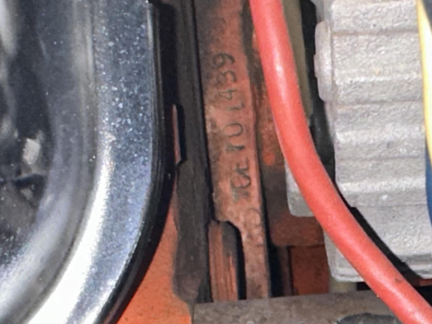

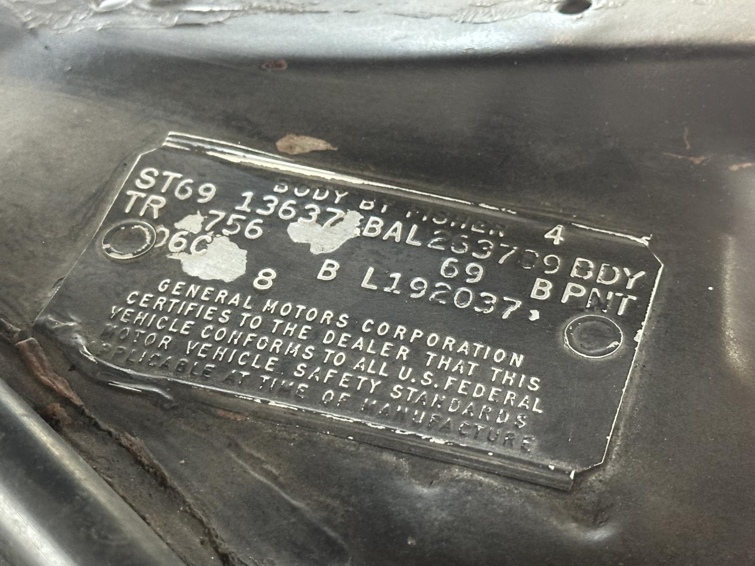

I looked this over while at Mecum Indy. Attached are photos of the trim tag and CE stamped block. I didn't crawl under the car to try and get a photo of the rear stamp. Nothing about it made me think it was a COPO. They only mention the COPO program in the auction listing but don't specifically call this particular car a COPO. I wonder if the current seller will provide a photo of the rear?

Forgot to attach them in previous post.

Thanks, agree that the trim tag doesn’t look consistent with other COPOs.

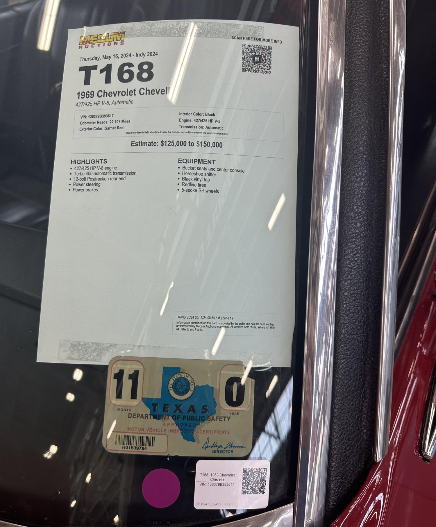

----Can someone from Texas tell me why the Texas window sticker has a ) for the year? That trim tag is a bit confusing for sure!....Bill S
Believe that stands for the last digit of the year Bill.
Seeing as Texas didn't start that Inspection sticker design with a barcode untill the year 2000,it has to be from the year 2000.
----Thanks,,,You spotted that minor keybord mistake, that I just noticed and fixed. Makes sense....Bill S
