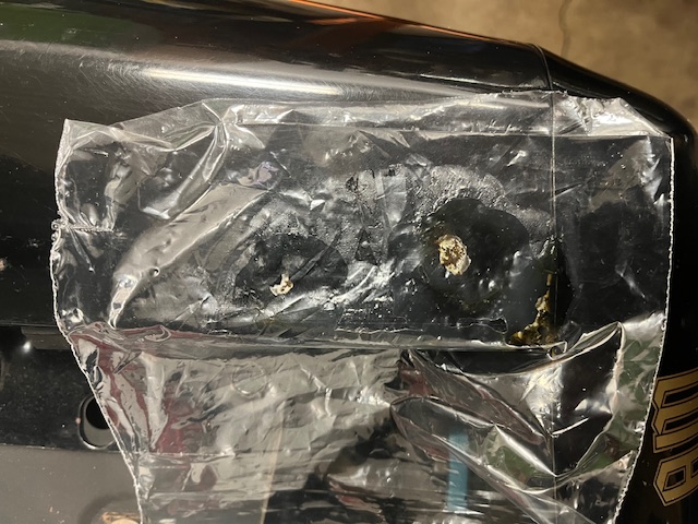

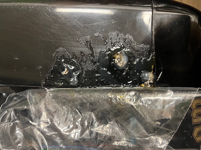

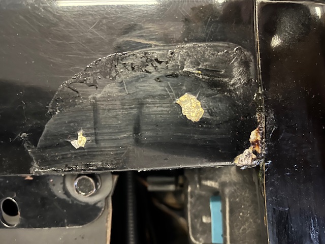

What about small areas where paint is chipped down to bare metal? Obviously, on your Corvettes, you don't have that issue.
What are you guys with survivor cars doing with something like that? Is it just "verboten" to apply touch up paint to small chips? Thinking you could clean it well, then judiciously apply one of the rust converters, then a small dab of touch up paint. Bad idea?
