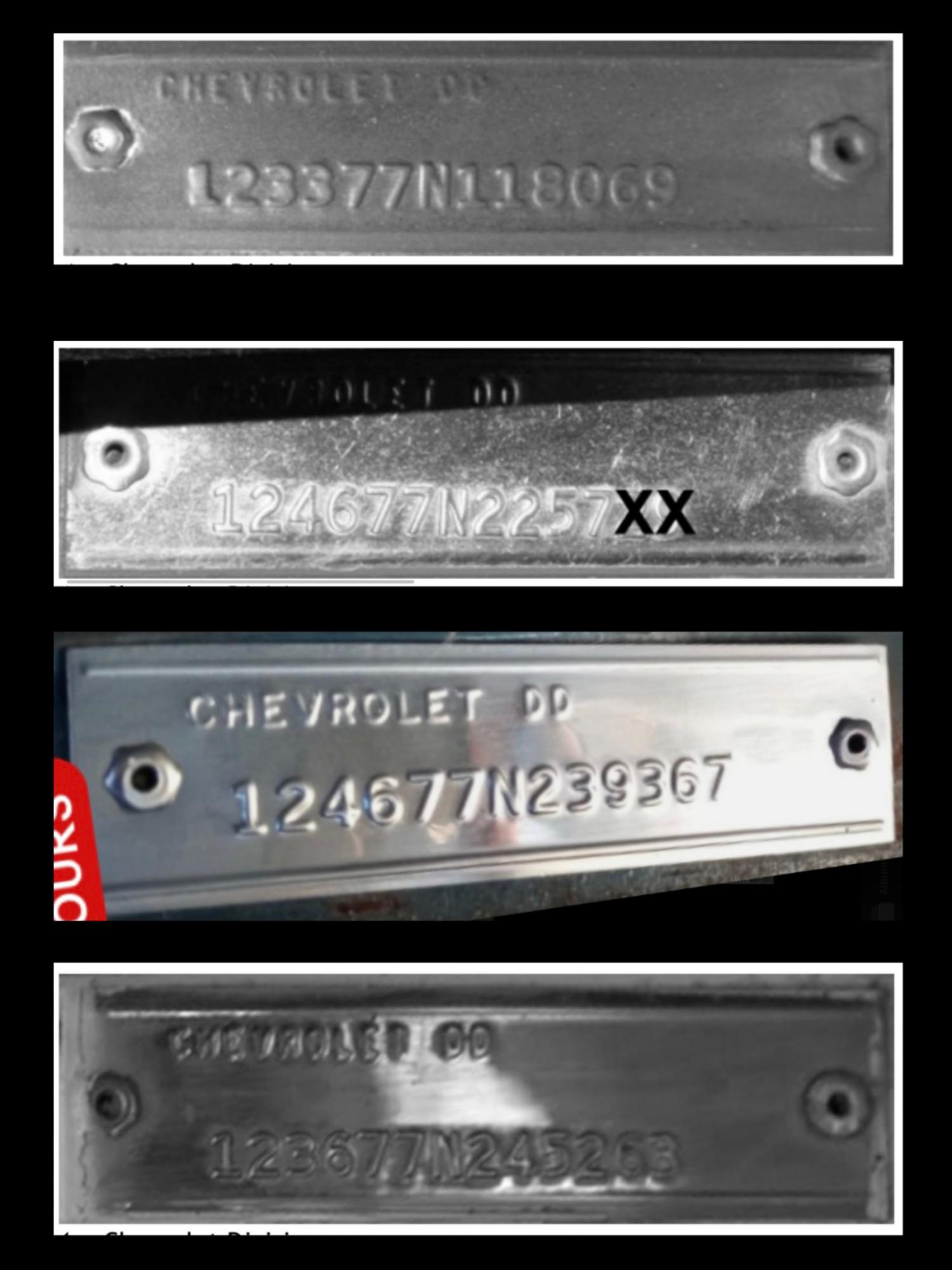

Missing trim tag, and a VIN tag and rivets that look WAY fresher than the door jamb they are attached to.
Any way to tell for sure if that is a repro tag? I notice it has the fat/wide, round O in CHEVROLET (rather than the narrower more oval shaped one). Which is correct for Norwood in 67?

Comparing w/ other Norwood Tags from CamaroWorld Examples as below, a few differences but most apparent off the hop is how VIN Stampings are all closer to bottom of Tags than Subject (w/ Red below) being much higher/larger space under stamping to Tag bottom.

Thanks for the comps! Lots of other differences too. The difference in font width in CHEVROLET is pretty obvious, the hook at the top of the 1 is different, as are the 6 and the 3.
Wonder what VIN is on the cowl, and wonder if the original tags from this car are out there floating around on another 67 Convertible ....

Subject VIN tag and rivets look brand-spankin'-new to me
