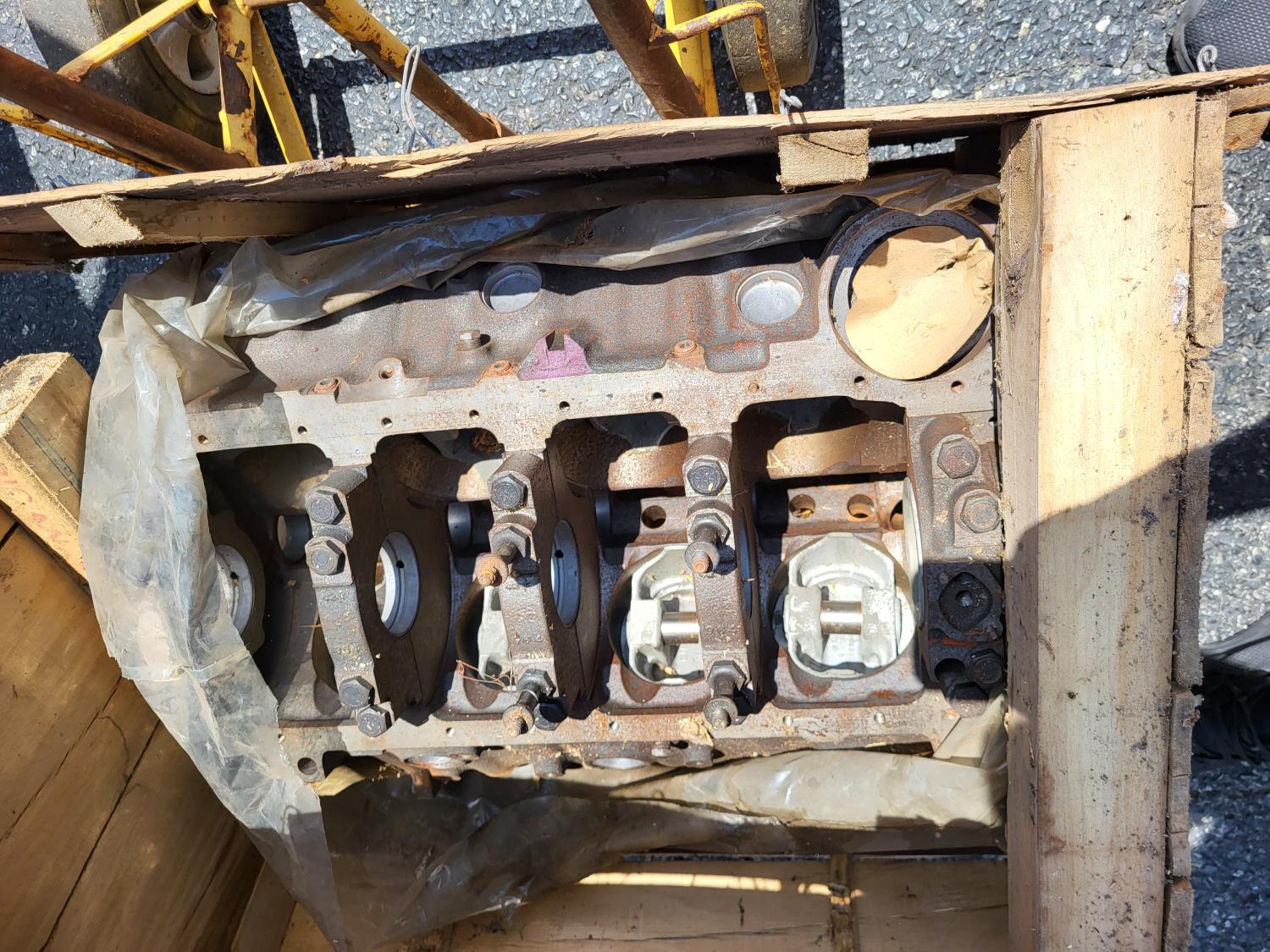

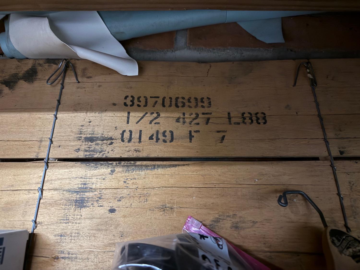

Default L-88 crate short block 3970699 new, motion correct?
I have a nos l88 short block part number 3970699 Would this be a correct replacement short block for a motion car?
I have a guy that offered me 6k for it , so what I’m asking is would it be correct for a tribute motion car or should I just build one from scratch?
Thank you

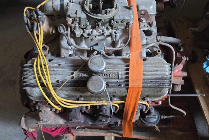

I also have a late 68 512 casting 427 that needs to be freshened but is complete so m not really sure what one is more correct and which one I should sell

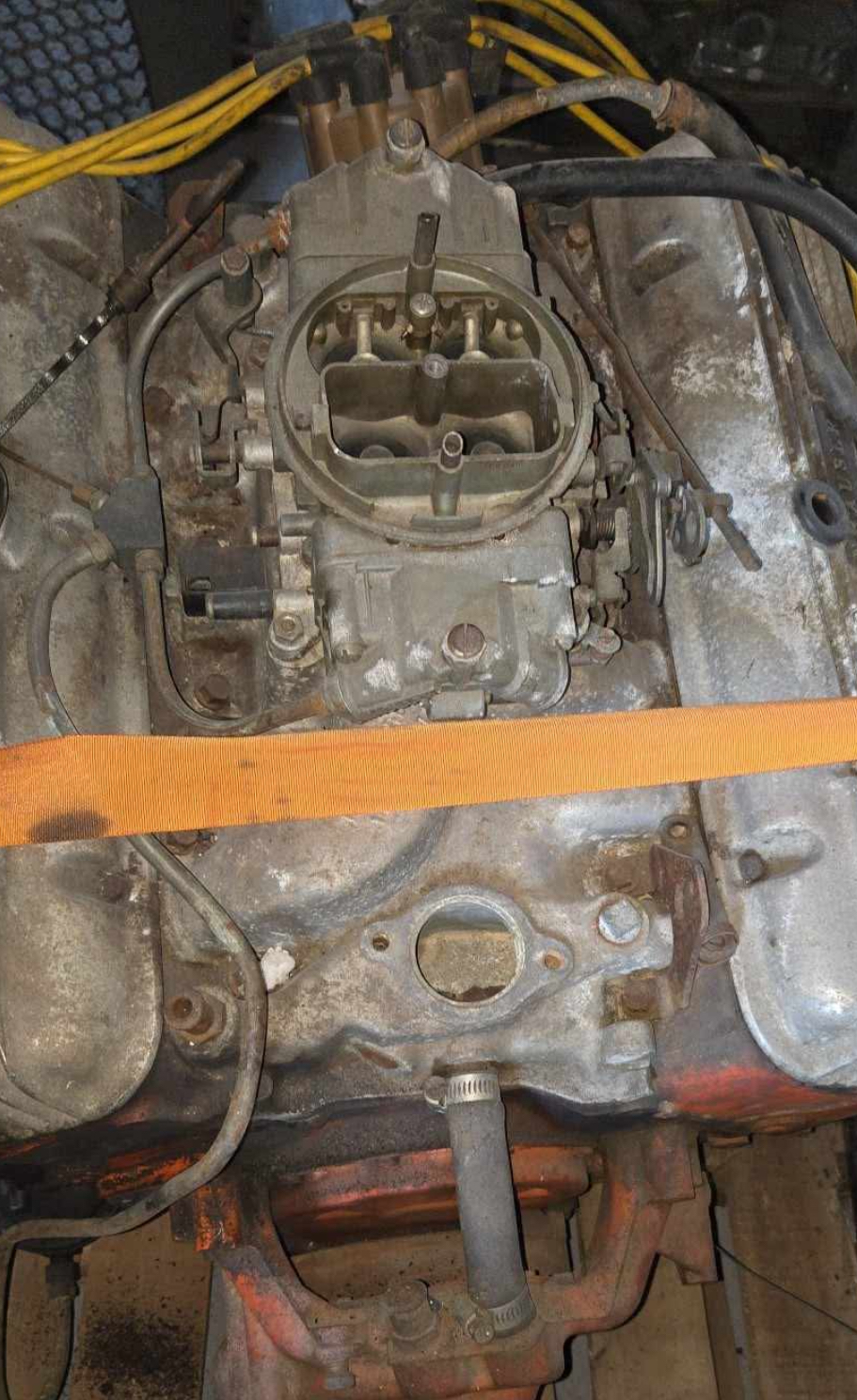

What is the fourth line into the carb "y" block for?

^^I would Guess a Day 2 exterior cowl mounted Fuel pressure gauge?

Does the NOS L-88 crate have a date on it?
I would think that is a NOS L-88 is a valuable item to keep intact with the crate

These crate L88’s were available well into the ‘80’s in short block form but were pretty expensive. An LS6/7 long block could be had for cheaper than the L88 short block but they were great donors for anybody needing a new reciprocating assembly for a ZL1 block.
