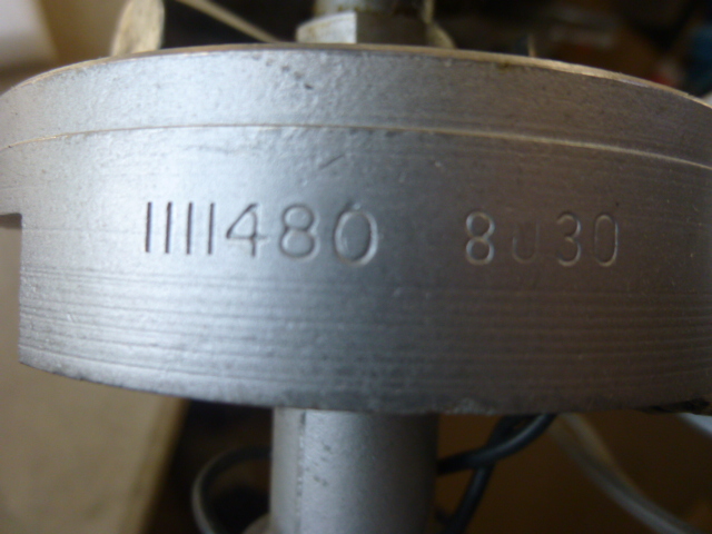

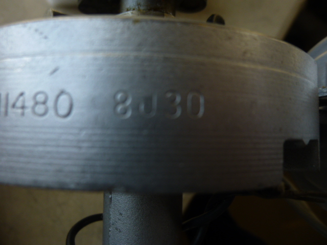

How does this one look?

Looks ok to me

Never seen a 8J30 date before and Ive had a bunch of these 480 distributors. Is there paint on it?

No paint.

Found pics of these two distributors both with same date. Pics are not the best, but fonts look very similar to OP’s stamping.
