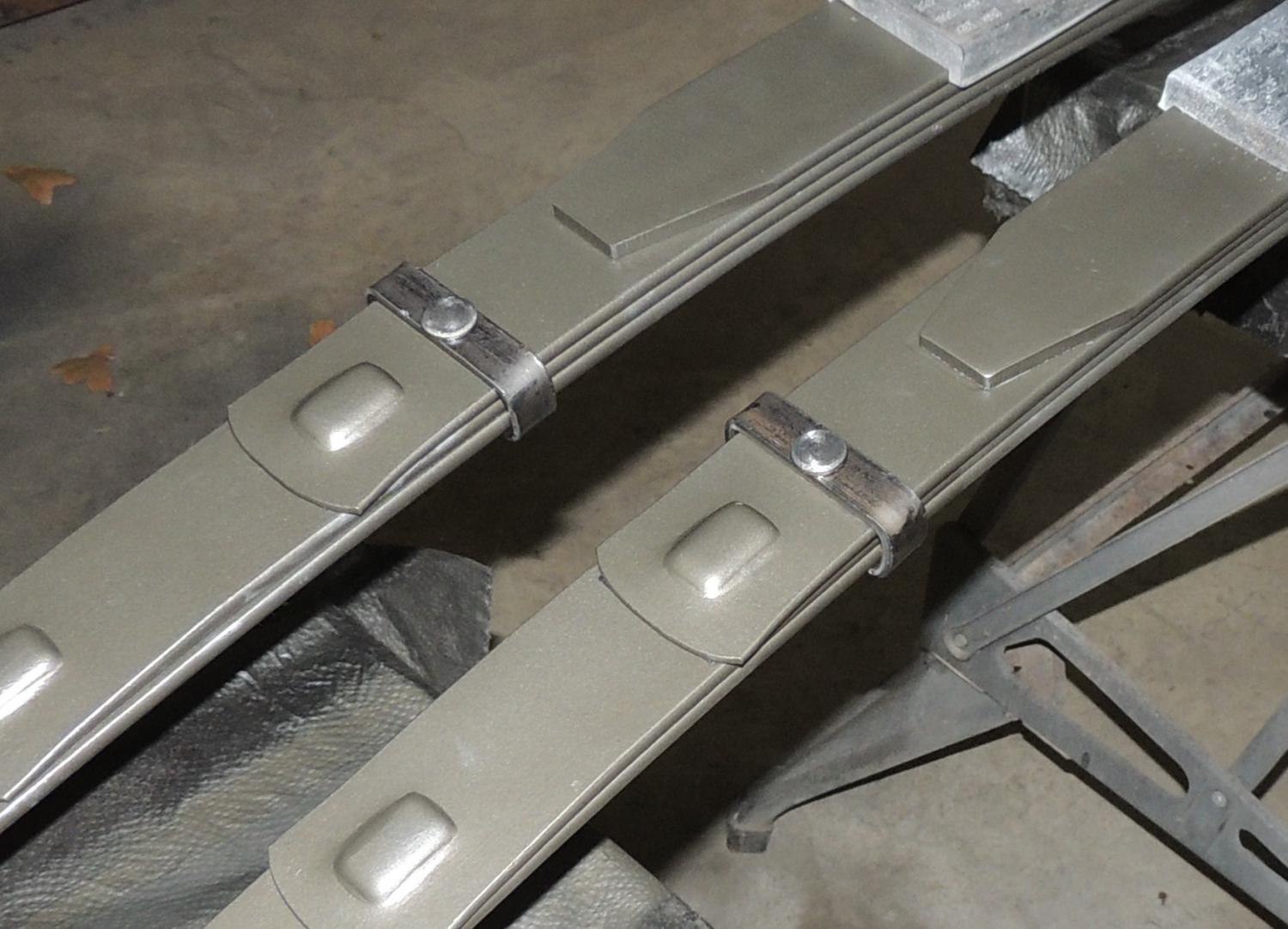

Where can I get the plastic insulators and clamps to rebuild my 69 camaro 4 leaf springs. The kits they sell are crap.

The insulators rarely wear out. You should be able to find some used ones.
I made my own clamps. You are correct, The repops suck.

Pic.

Give us a call at 1(313) 963 3839
Eaton Spring
Tip Insert
Part number
33CI33 * 2" x 2-1/2" for oblong cup $ 2.00/ea
69 Los Z11
68 SS/RS 396/325
68 Los Z28
