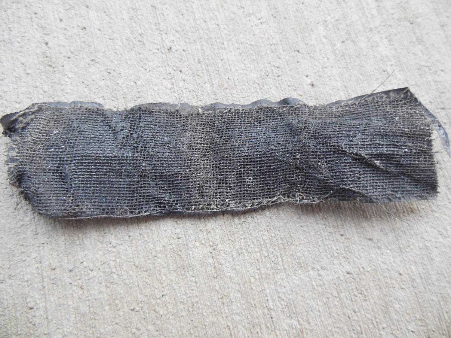

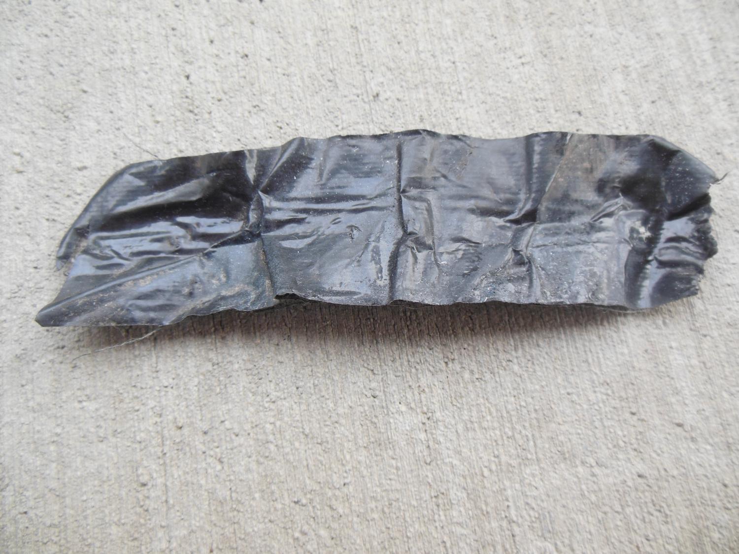

Old 09-14-2024, 03:11 PM
ALLZS ALLZS is offline
Join Date: Dec 2007
Location: ST LOUIS MO
Posts: 1,987
Thanked 126 Times in 69 Posts
Default tape
here is a sample of the original tape on the harness its vinyl on the out side and mesh on the inside

ALLZS, Wow look at this rear harness on Facebook.
Link
https://www.facebook.com/photo?fbid=...71228623122319
Your Sample has, as does this removed rear the Plastic tape AND the Mesh. I reworked my 69 Pacers rear years ago and do not recall the Mesh. I know of no exact-reproduction tape out there at this time. I will peruse the 3M web site, It Certainly WAS not adhesive coated on BOTH sides.
