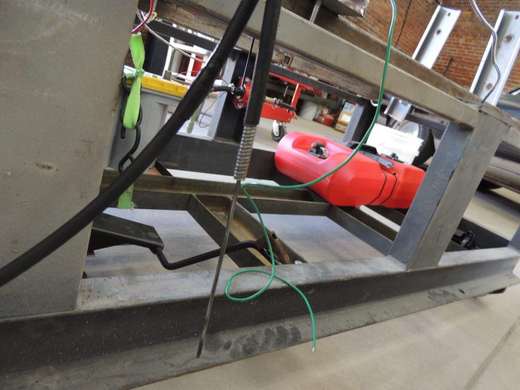

Decided to build my own. I have a good start. This is an extra body cart I got with a lot of parts I bought last year.
Really heavy "C" channel construction. The six pads on top are all 3/8 steel.
Figured I would build some dedicated stands for a Chevy. Then, when I get to the Studebaker supercharged engine, build some dedicated stands for that motor. Then, when I am ready to run the Ferrari V12.... well, you get the idea.
Anyone have some decent "plans" for an engine run test stand. I will adapt whatever is out there to this cart. It is 52 inches long and 26 inches wide.

Plan to put some larger casters on it with locking feature.
