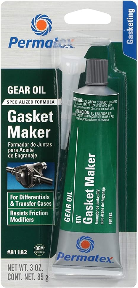

Default Change gear oil in a 12 bolt
Hi guys,I've never changed the oil in the 12 bolt of my Camino.Would 2 quarts of 80w90 and a 4 oz.bottle of posi additive be enough?Thanks,Bill.
