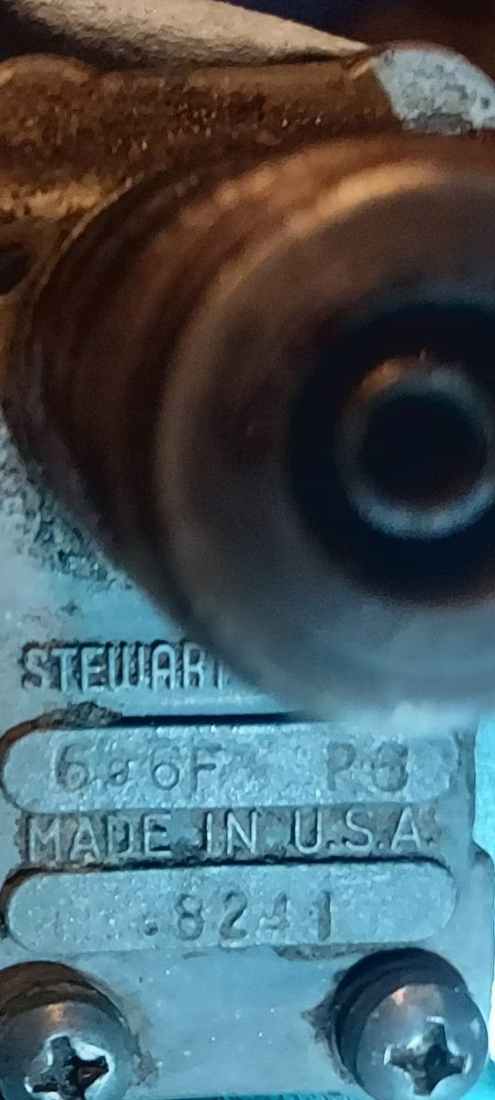

I bought a low mileage Muncie and this was on it. Anyone know how to decode it? I think it's part# 3950352. Thanks

SW date code info.
summitracing.com/Stewart Warner date decoder

and more here:
https://garbee.net/~cabell/stewartwarner.htm
http://www.gmpartswiki.com/getpage?pageid=12662
