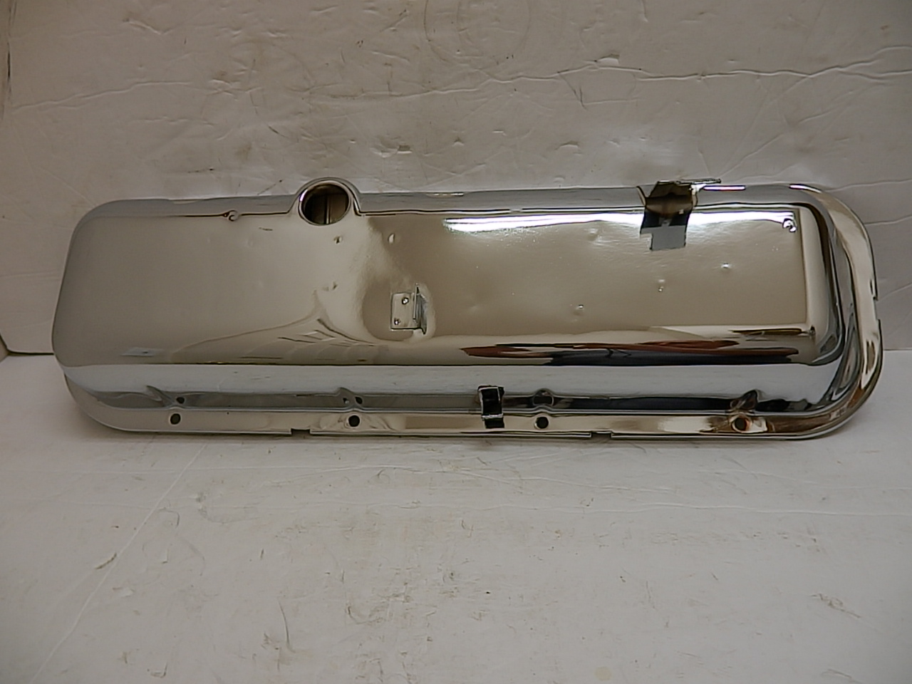

I’m having a difficult time finding a chrome plating place that can restore a set of 1969 Corvette BB valve covers.
All places can chrome them, but no one can do the flash chrome process. Which from my understanding is just nickel and chrome. No copper.
Additionally, none can guarantee that they can preserve the factory spot welds.
They all say those will most likely get polished off.
I’ve called over 20 places with no real luck.
My question is where are all of you sending valve covers to get chromed?
What are you requesting? Show chrome?
It took me forever to find the correct valve covers for my 1969 Corvette L89 and at this point I’d be happy to have them chromed as long as the spot welds were preserved.
Attachments - The Supercar Registry PC230019.jpeg PC230016.jpeg PC230012.jpeg PC030004.jpeg
