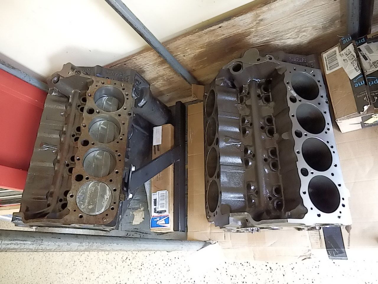

I am looking for a set of 8 NOS pink rods for a 68 Z, I would also consider a nice used set with no issues. PM's Only or 7one7, 3four8, 2four2four.

Two different rods used depending on early or late built.
Early were still press fit. Late are full floating. Corresponds to the piston usage.
Early used separate valve reliefs. Late was the trough style single valve relief.

I need them for a NOS 1968 CE short block with a casting date of E128.

Normally, that piston has the full floating rods.
