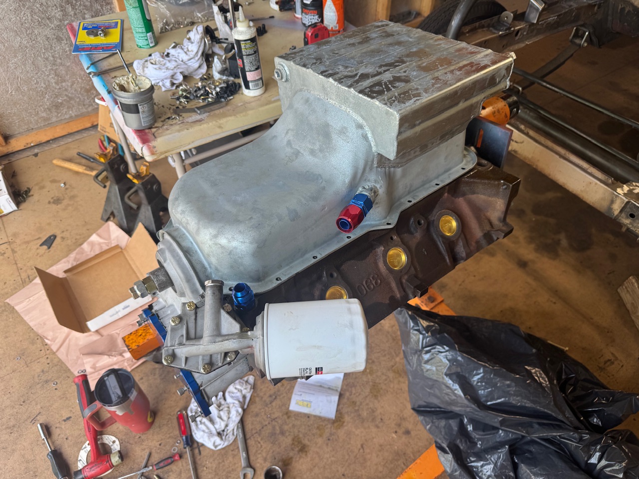

So the original plan for the engine was to use parts I had laying around to put something together, unfortunately the original 360 block I planned to use was no good(cam bearings were loose) so that block got used for mockup and a 68/9 390 block and crank I picked up rough and cheap got sent to the machine shop. Where it all still currently is.
I started ordering parts planning to do a 12.5:1 390 with my tunnel ram and twin Dominators. But a mistake I made ordering pistons turned into something better. The pistons that showed up from weisco are dished pistons, putting my compression ratio at 10:1 at the best. But when something like that happens the best thing to do is bolt a blower on it. So I picked up 3 8v71 Detroit diesel blowers(1 is actually for a 92 series). And I’ve ordered all the parts to convert one to gas use. AMC blower manifolds are incredibly expensive, so I sourced an Offenhouser dual quad manifold and sent to a local machine shop with the blower for mock up. He’s going to modify the Offy manifold and weld a plate to it to mount the 8v71 blower. Otherwise the engine is a .030 over 390 with forged Weisco pistons and Molnar connecting rods. Crower is making a custom cam for the blower(they’re also taking back the other cam I originally ordered for the higher compression build so I can’t recommend them enough). It’s going to be a solid flat tappet custom grind with about .550 valve lift and 114 lobe separation. The heads are ported 1970 390 291C cylinder heads. I’m hoping to make between 8-10 pound of boost with the blower.

And finally here’s where we are today.
Ran to the machine shop and dropped off the pistons, stopped by the other machinist doing the crank to drop off 1 rod with a bearing in it for him to measure and start cutting the crank. I’m still quite a ways away from building the engine but it’s coming along. The heads are being worked on, the block is being sent out for align honing before the crank bearings get installed and measured so the crank guy can cut the mains to size so all my clearances are 100% right the first time. Hopefully by the end of this month the block will be mostly done. We’ll need the crank to mock up and see how deep in the hole the piston and rod combo is. Since I’m using 401 length rods and pistons I’m going to end up down in the hole probably .040”. But for a low compression blower build that’ll probably be ok. Came home and began mocking up the ladder bars for the front mounts and the headers so I can start cutting things. The drivers side fits minus the steering shaft. The passenger side is a shitshow and will require quite a bit of cutting to fit. I’m trying to jam Hooker 7103 AMX 1 7/8 headers into an area not designed for them at all. Luckily since I’m not using the front suspension mounting holes I can cut what I need and go back and clean it up later. Thanks for reading.
