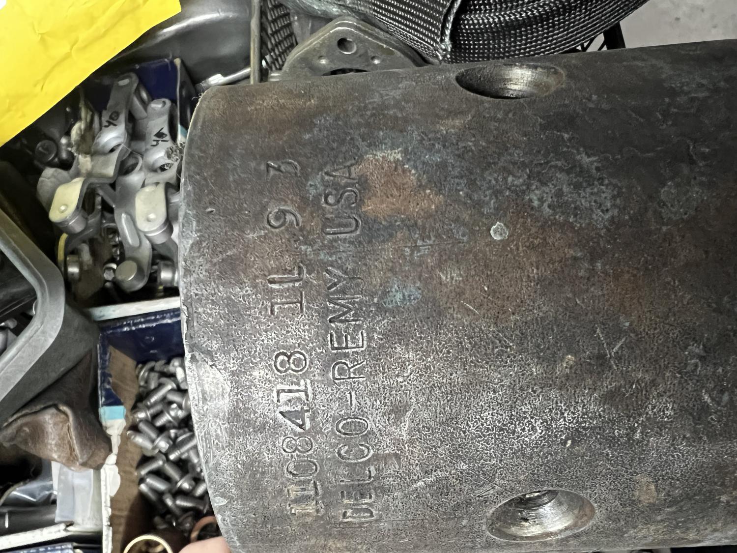

This is close. Nov 9 1971.

Would this be correct for a Flint engine build cast date of January 27th 1972? This picture shows December 1971- 9th day, am i correct? I thought L was Dec?

M is Dec. I am not sure if it is close enough being 79 days before the engine.

L stood for November,They didn't use the letter I.

I think the confusion comes from items that were cast like waterpumps, intakes, heads used the letter I. Alternators, distributors, starters etc did not use the letter I.
