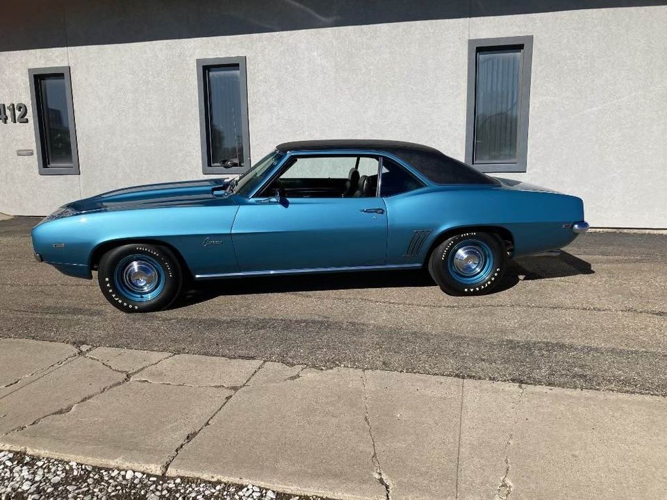

Default 1969 Camaro COPO 220K for sale Marketplace
https://www.facebook.com/marketplace...7-c904fdfbb222

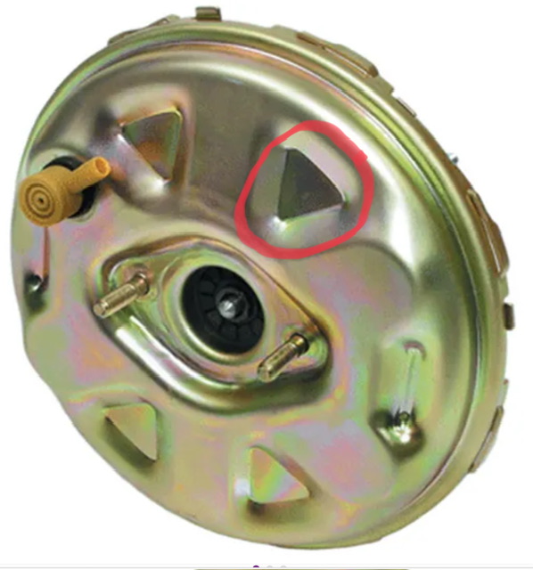

That much money and chinese booster

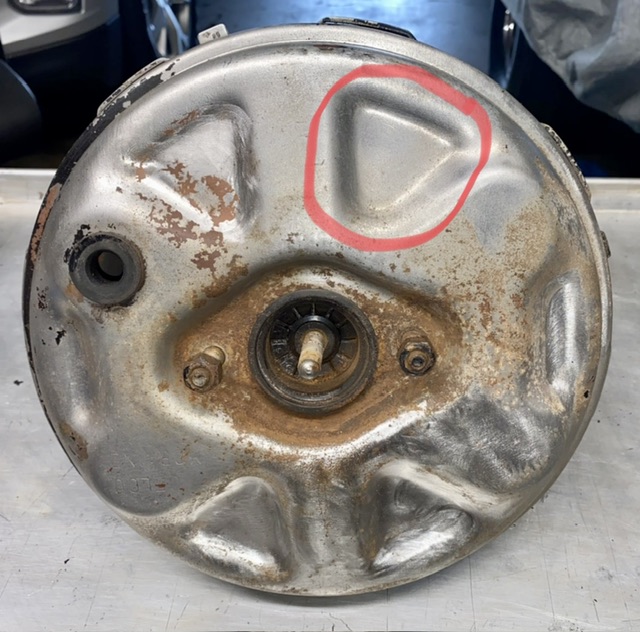

Bill, would you PLEASE show us what the correct booster/master looks like. I need to know. thanks and regards

The booster is aftermarket, did not want to say anything....Original Booster has Upside down Delco Morraine logo. I can send you pics.

The top one is aftermarket….the lines on the triangle are too defined/sharp, compare to an original one, shown below.

also the "O" in Delco is round on repops - oval on originals.
