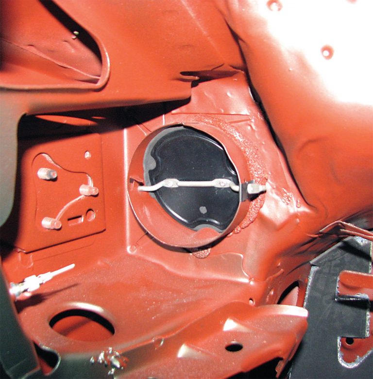

This is absolutely hilarious.
You bid 100k on a car and dont do basic research on what a w-31 is?
https://www.mecum.com/lots/561598/19...utlass-s-w-31/

Old 05-18-2023, 10:20 PM
Posts: 6,192
Thanks: 1,519
Thanked 1,806 Times in 867 Posts
Fake because they were not available with a/c?

How does a car become a AACA grand national champion if it is fake. Or was that misrepresentation also. Please explain how it was determined it was fake and what in fact is fake. Inquiring minds want to know, it was a decent looking car.

Old 05-19-2023, 01:16 AM
Ryan1969Chevelle's Avatar
Join Date: Nov 2012
Posts: 5,963
Thanks: 585
Thanked 879 Times in 460 Posts
Ouch my head hurts!!!
No W31 was built with AC, it’s one of the first tip offs.
Ryan W31
rsinor (05-19-2023)
Old 05-19-2023, 01:28 AM
Rsconv68 Rsconv68 is offline
Join Date: Jul 2022
Posts: 259
Thanks: 15
Thanked 127 Times in 75 Posts
Probably added during the restoration or just wasn’t a 31 car to begin with.

Old 05-19-2023, 10:05 AM
tom M tom M is offline
Join Date: Aug 2019
Posts: 38
Thanked 50 Times in 12 Posts
no ac and no power brakes with w-31 package
to change over to a/c would require a whole new firewall & vent system
would litearlly need to remove body from frame to make it work
this looks like a blue 4sp cutlass that sold on ebay back in 2012
