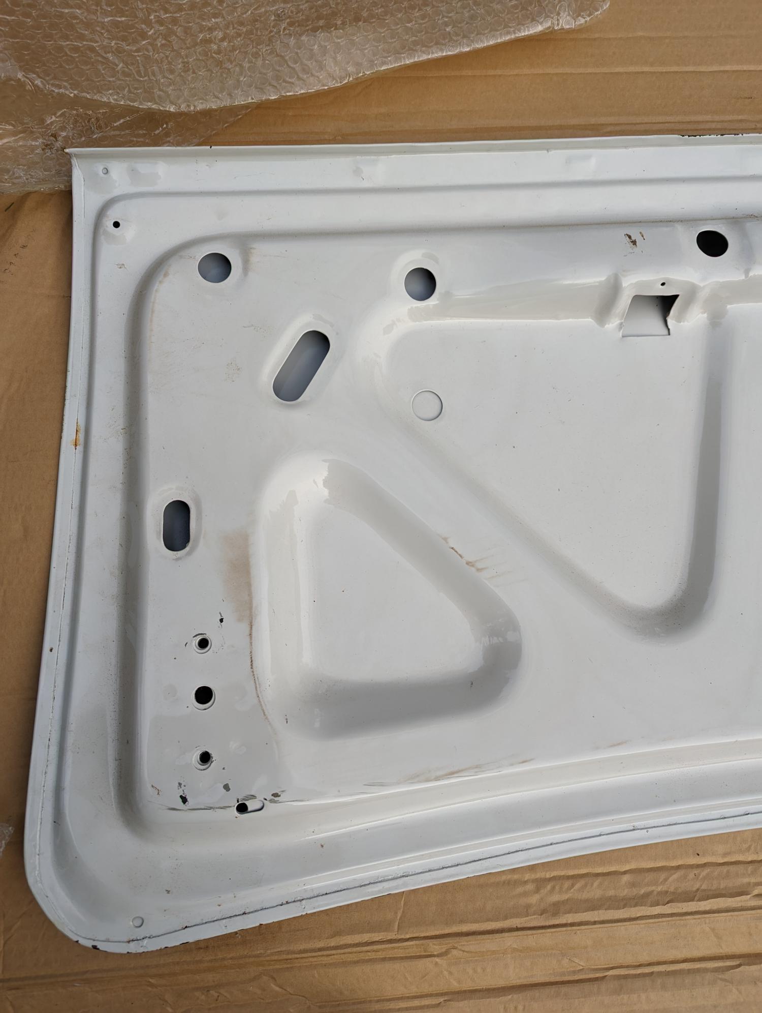

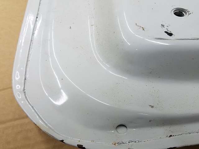

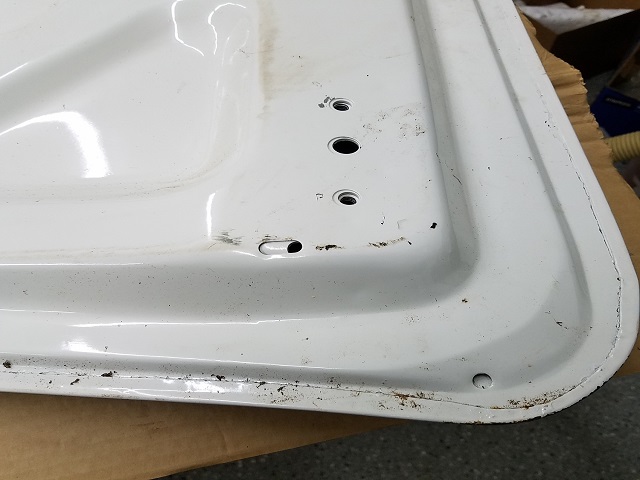

I have a 1st Gen Camaro Deck Lid......
1) Painted White on Inside but still Black Primer Out
2) No emblem piercings
3) No date codes that Ive seen
Can this be any form of GM/OEM or is it Aftermarket ?????
Chuck Sharin

It is aftermarket I believe judging by the hinge holes/threads.

Square nuts are visible inside hinge holes on GM deck lids. How well does it fit?
My guess is someone painted underside then installed and found out it fit poorly.

The picture speaks for itself!
Your still waiting on other opinions?............. Gl with that.
