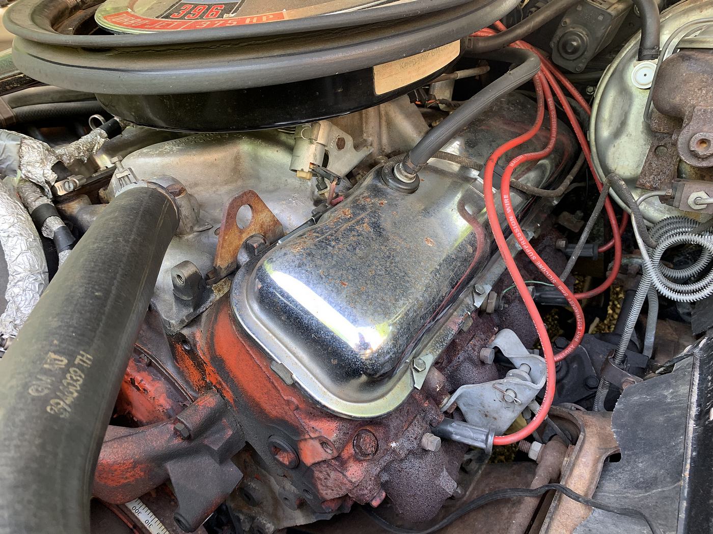

Did all 1969 L78 Camaros come with an idle kick solenoid?

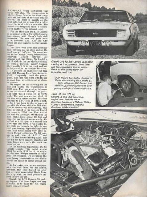

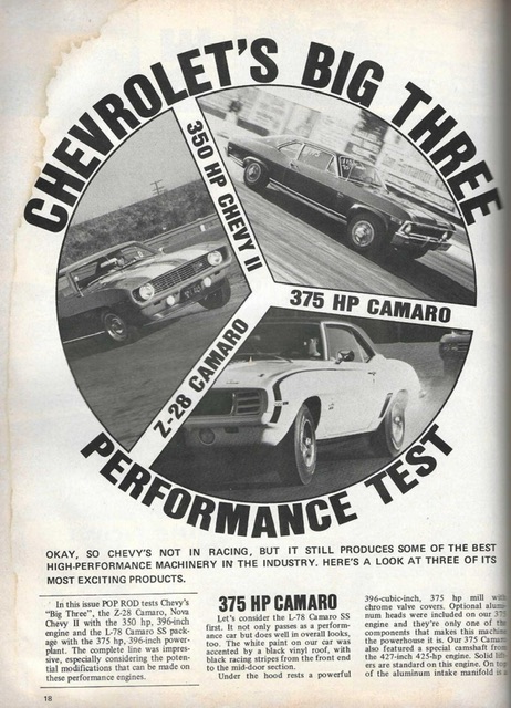

I checked out this article and the L89 Camaro in it does not have the solenoid on it. I’m not sure what the date is on this one but here’s some pictures!
