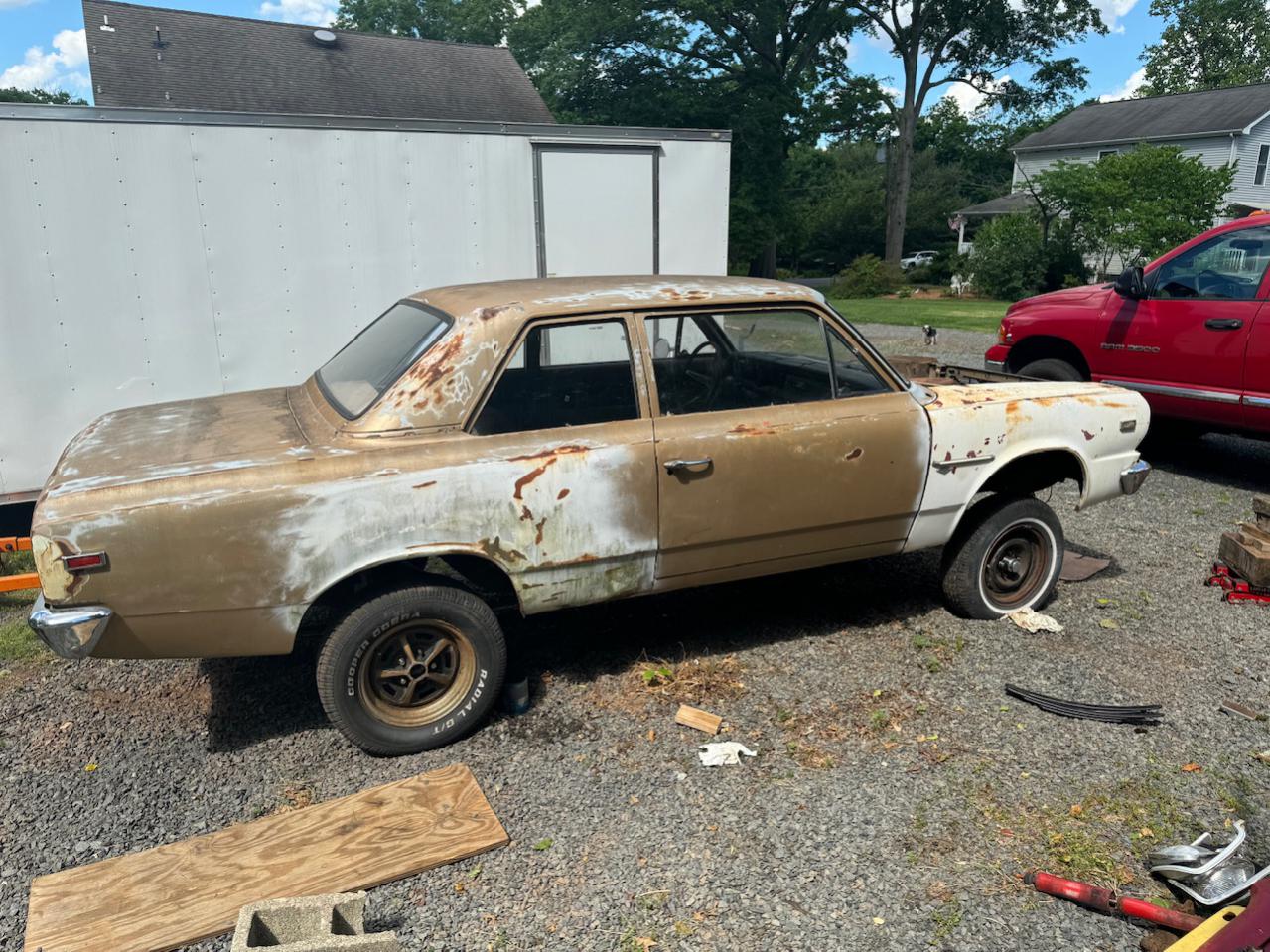

So I was born far too late to know, but for a gasser/street freak in the very late 60’s and early 70’s, what type of traction device would’ve been used on a lead spring suspended rear axle?
For what I’m building and to fit N50’s hanging out the side I’m going to flip the rear so it’s spring over axle. Would some type of ladder bar have been standard fair back then on something like that?
I’d like the car to sit something like this Falcon when done. Even though im building a Rambler.

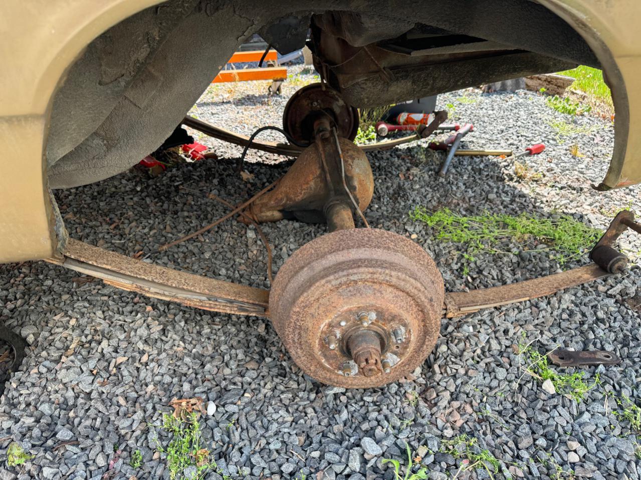

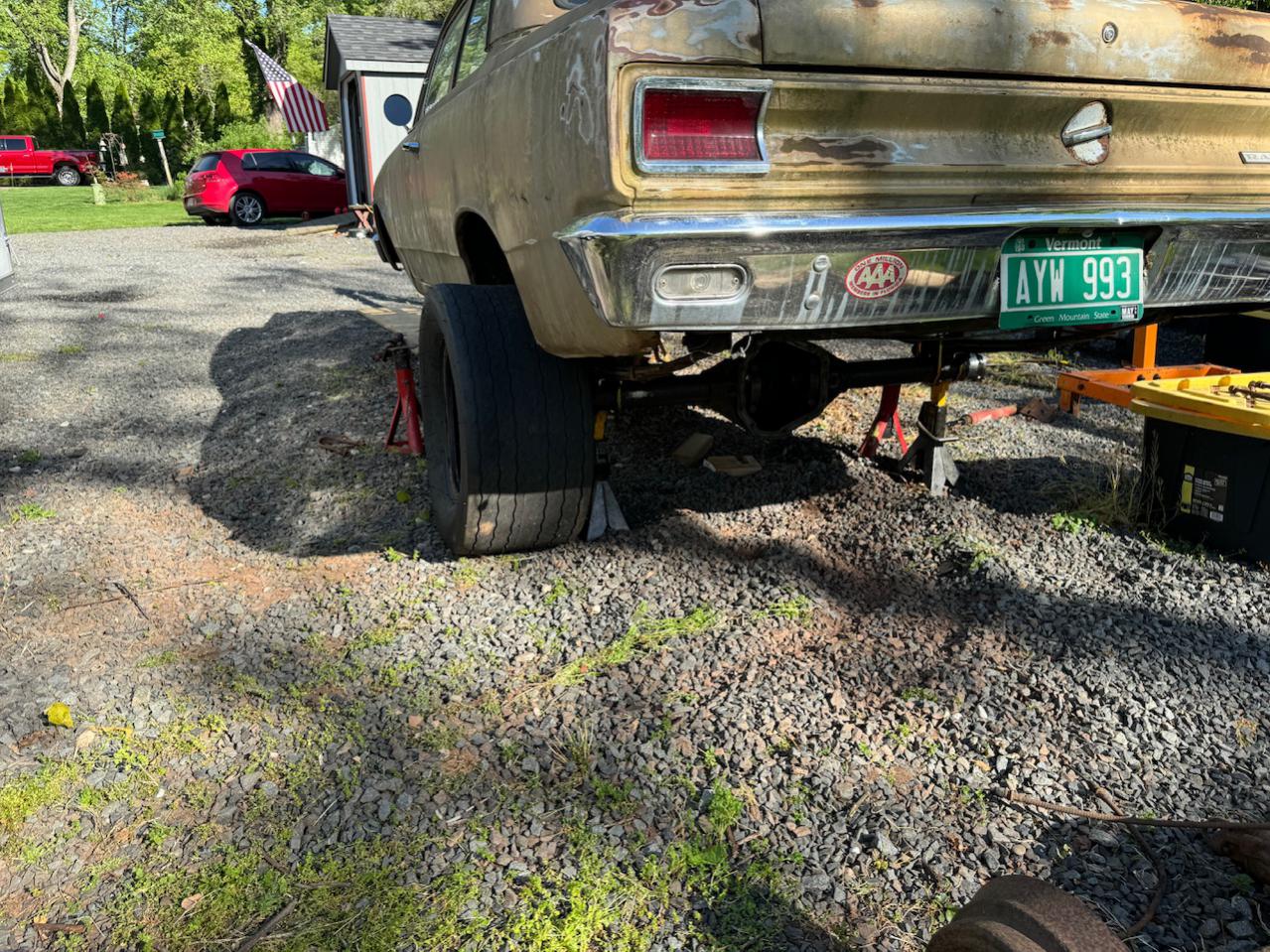

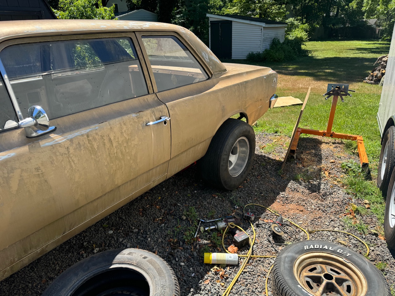

It’s all coming together. Narrowed truck Dana 60 swapped in with the perches up top.

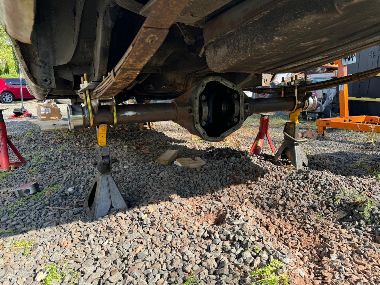

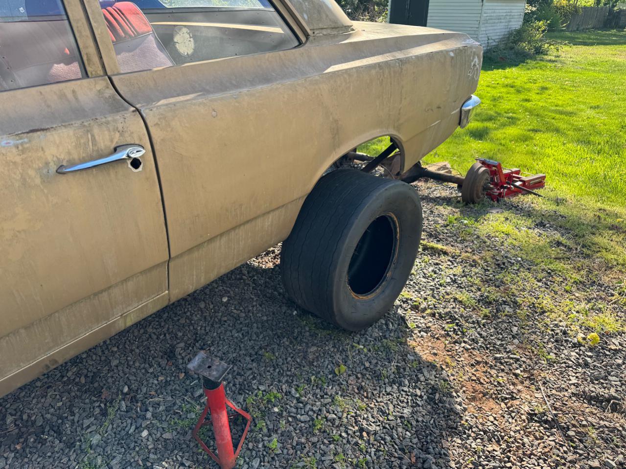

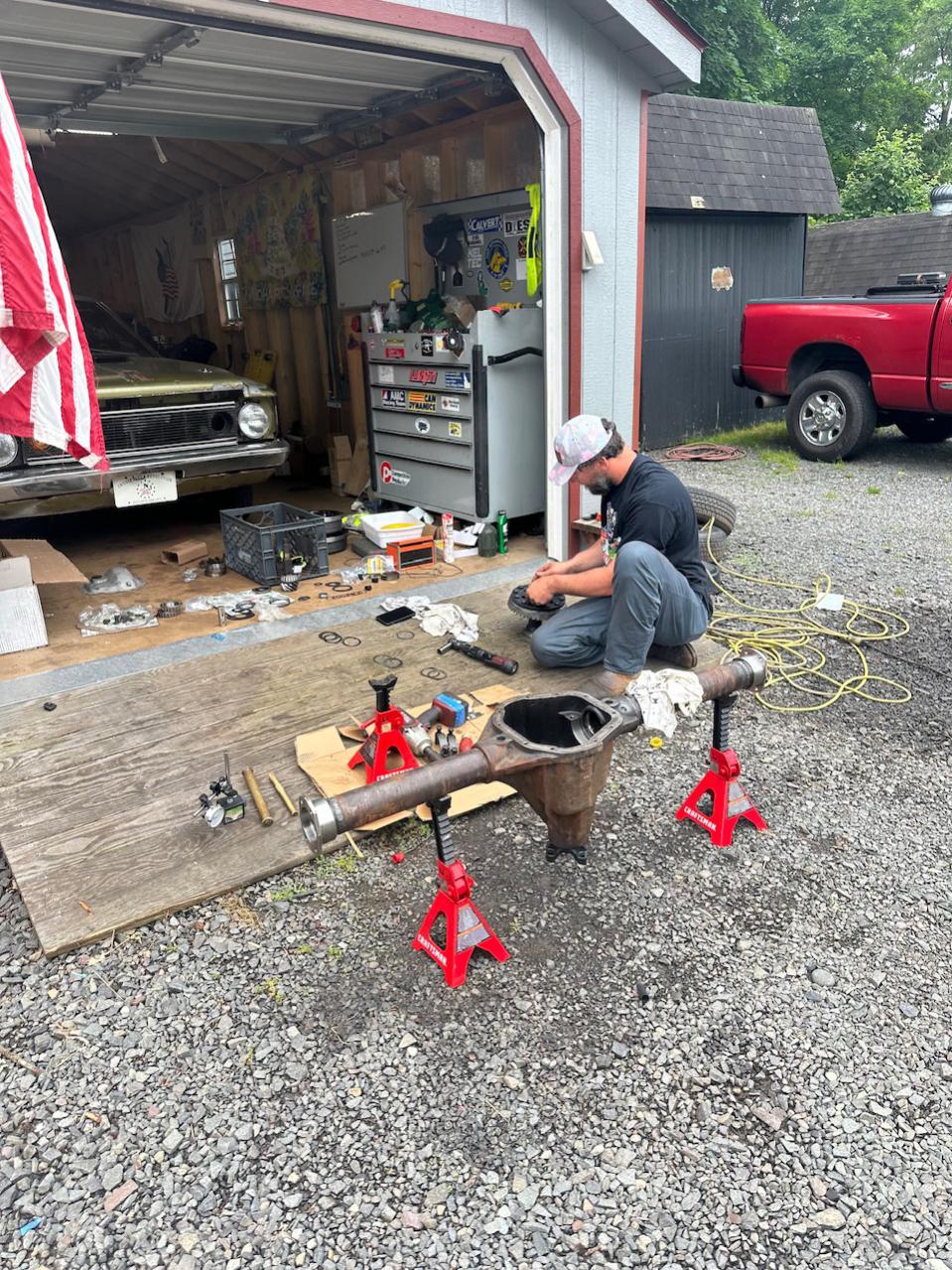

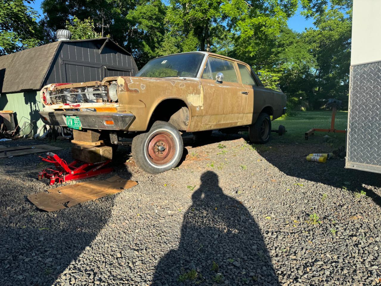

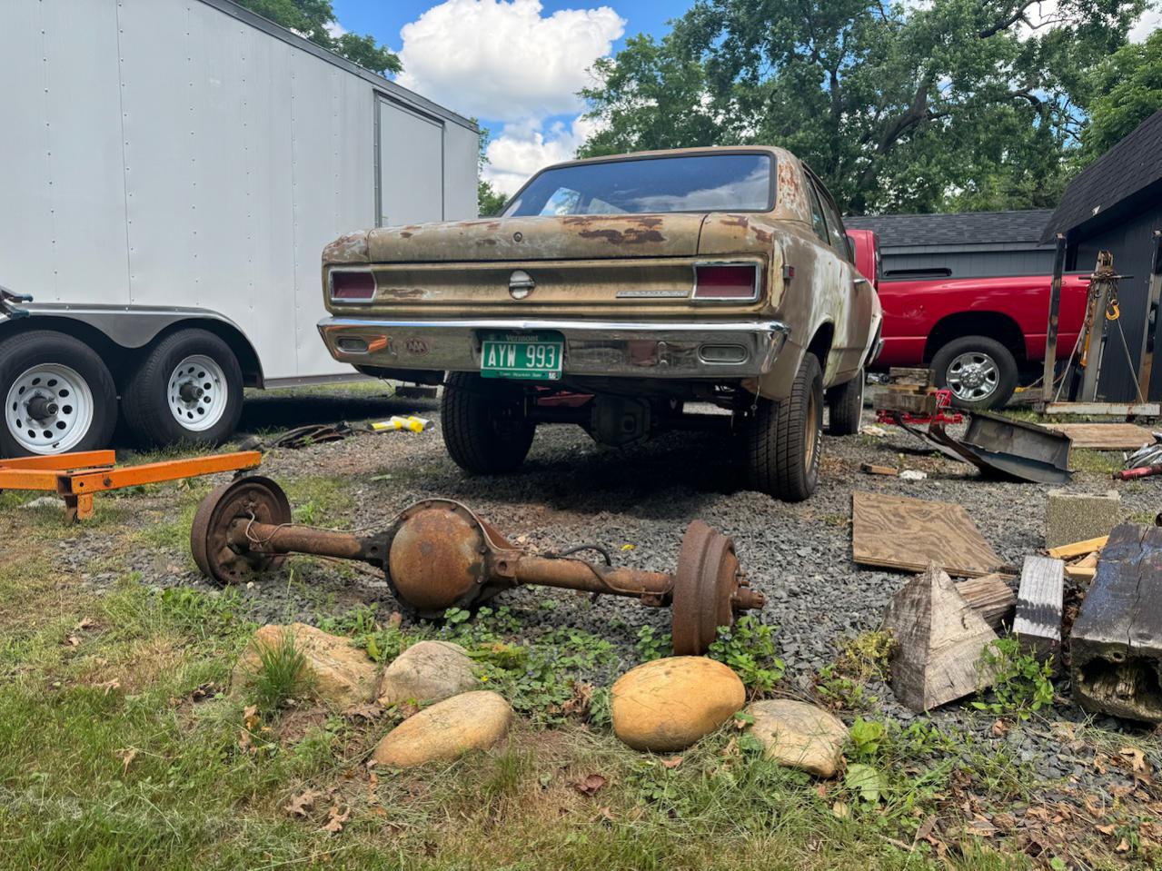

Not sure if I should start a build thread in the AMC section for this. But here’s where it currently sits. Ended up removing 3 leafs from each side as the leafs speedway provided were way too heavy. The rear is sitting spring under. With 5.13 gears and a spool.
Built the rear with my dad on Memorial Day. Measured for the steering linkage. Pretty soon it’ll be moved into the garage so the bodywork and other repairs can start. I also need to figure out the Ladder bars for it.

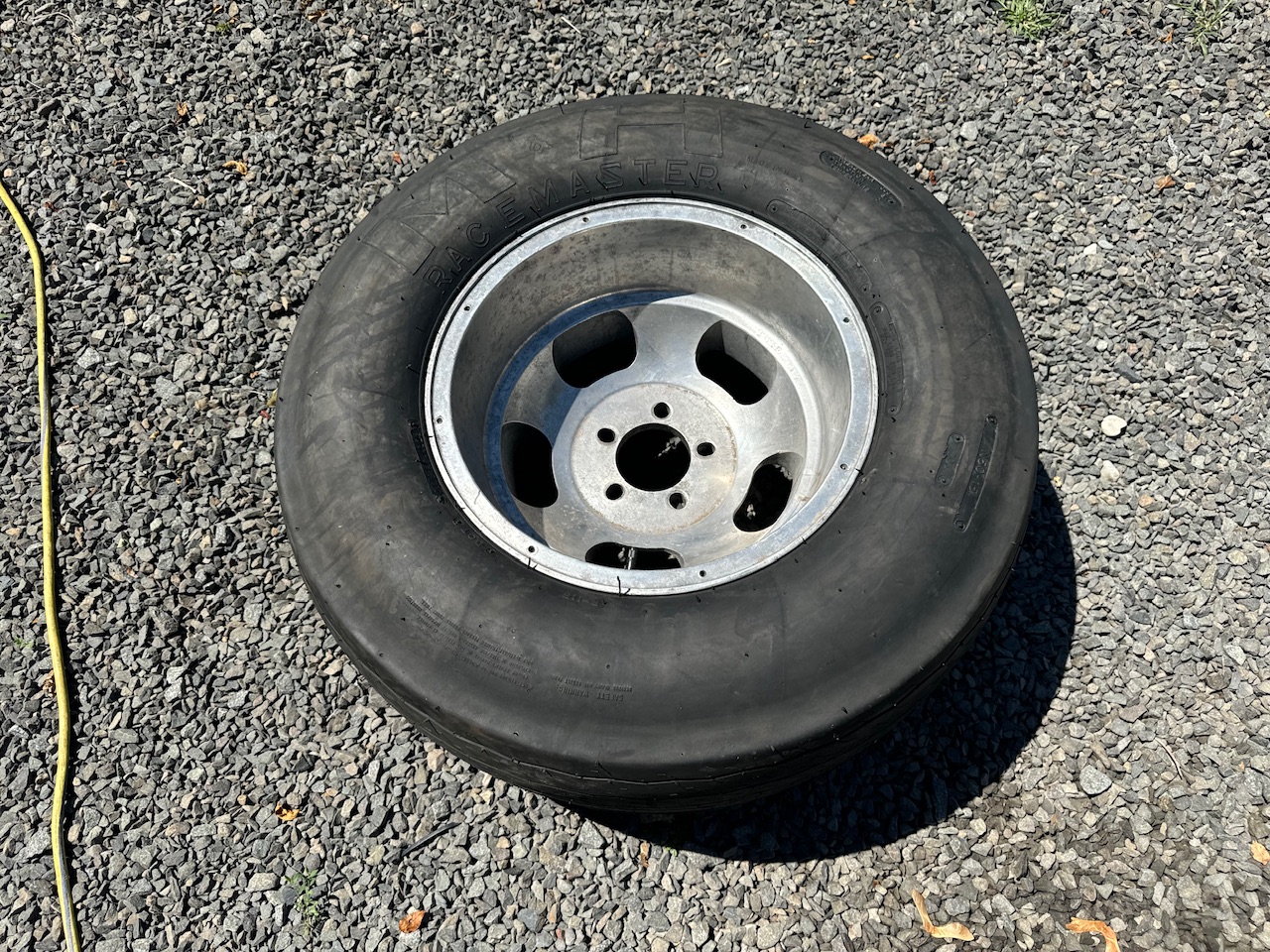

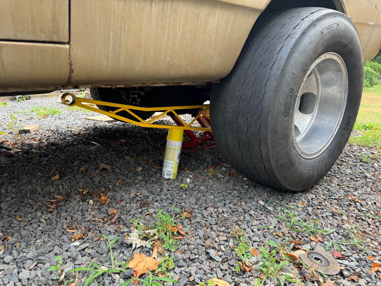

GM A body Lakewood ladder bars and N50’s on 15x10 slot mags look good. I think it’ll fit the era I’m going for. Now I wish I could find a used GMC 671 blower to rebuild.
