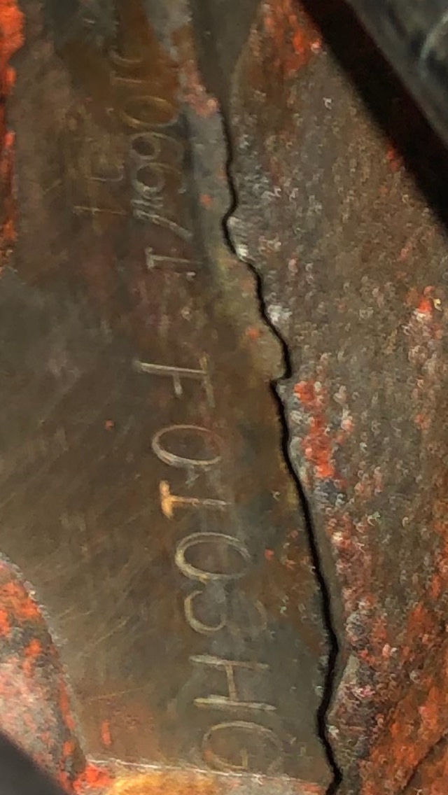

Opinions? Looks like a restamp to me.

IMO first set of numbers were not struck with a gang stamp.

The font and size of the numbers look off to me. The car in question is a '65 fuel injected Corvette that I looked at yesterday. I was thinking about buying it but not interested in forgeries.

Not good.
