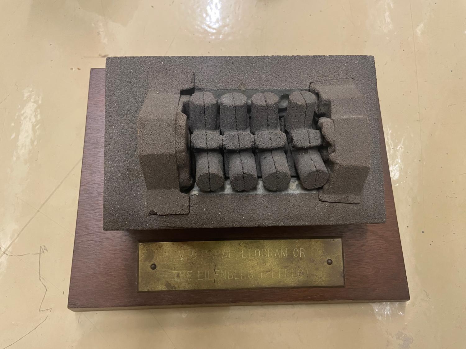

OK - rainy day here & I just got off the phone with Mark B. Mark asked some questions about the foundry molding process, so I figured it best to post some info for the community. Conveniently, I had the pattern shop make up a gift for Jim McLernon (GM of all Chevrolet manufacturing) that I gave to him when he visited our plant. when I left Chevrolet - the plant gave me the same gift (a miniature cylinder block) along with the molds that it took to produce it. I dug them out & can use them for illustration.
First - the top (cope) and bottom (drag) halves of the molds were produced in "green" sand (silica sand bound together with bentonite clay & water). A container (flask) was placed over the pattern, and sand was automatically dumped on top of the pattern/flask assembly. Next, hydraulic squeeze heads compressed the sand/clay mixture against the pattern. When the flask was lifted off of the pattern, it contained a perfect impression of the pattern in the sand/clay material. Using my miniature parts - here's what the bottom mold and some of the cores that had to be set into the mold looked like:

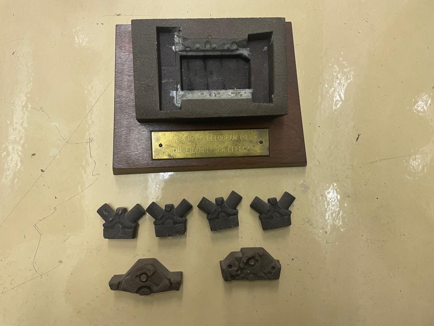

Next, the cores that formed the interior & re-entrant parts of the casting were set into the lower mold. Not all of the cores are shown here, but you can see the front & rear housings along with the barrel cores.

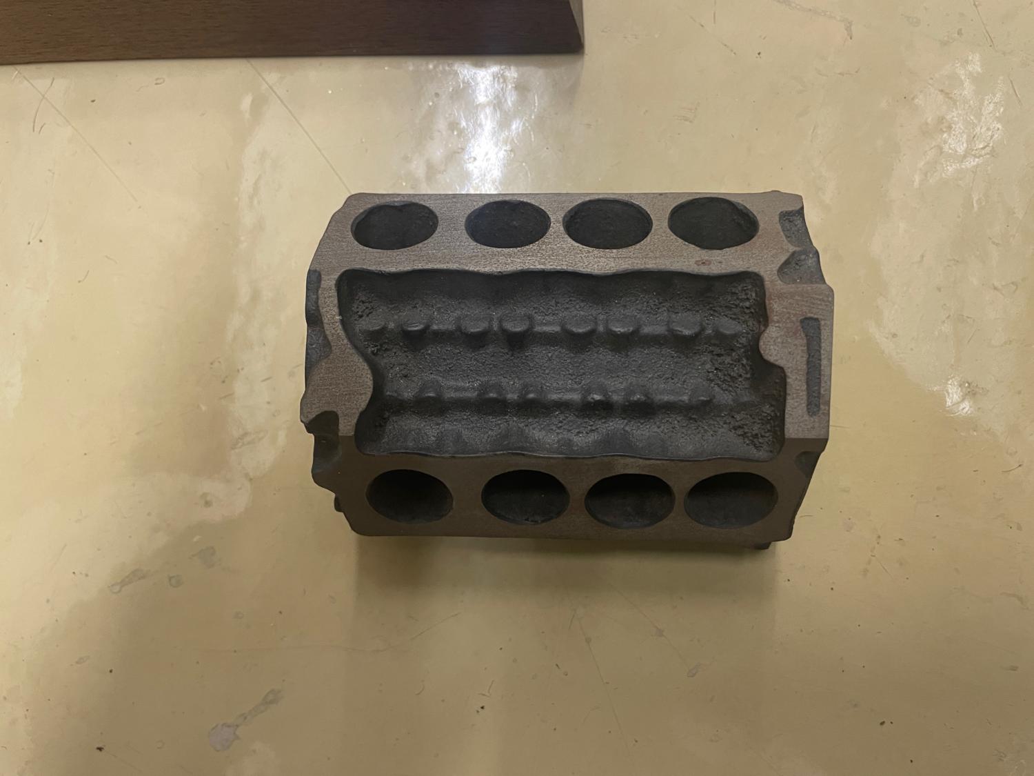

Finally, the mold was closed by setting the top half flask (with the green sand impression of the top of the casting) onto the lower half of the mold (with cores in place).
Then - the completed mold traveled on a conveyor to the metal pouring station where the mold was filled with molten iron at roughly 2600 degrees F.
After shake out, blast cleaning, and grinding - that block looked like this
