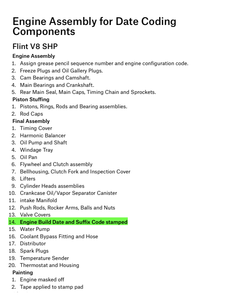

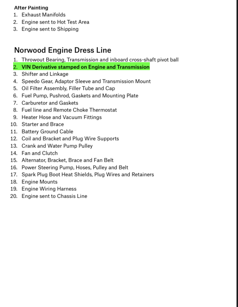

Here's my list for date coding engine components based on information provided by John Hinckley at the CRG.
Date coded components installed at the Flint Engine Plant would pre-date the engine build date stamped on the block pad.
Date coded components installed at the Norwood Engine Dress Line would pre-date the cowl tag build date although there are some documented exceptions to that.
My understanding is that dated components can pre-date the engine or cowl tag build dates by approx. 3 months.
At Norwood, the vin was stamped on the engine and transmission just after they were mated on the Engine Dress Line.

Alternators were not installed on the engine at the engine plant. The alternator (along with its brackets) was a vehicle assembly plant item. The alternator (and brackets) are shown in the car AIM with part numbers (and the AIM does not show part numbers for any engine components that were already on the engine when the engine arrived at the vehicle assembly plant from the engine plant).
I would suspect that if a 68 was converted at Yenko, they simply reused the alternator that came on the car. So that should be dated based on the car build date, not the engine assembly date.

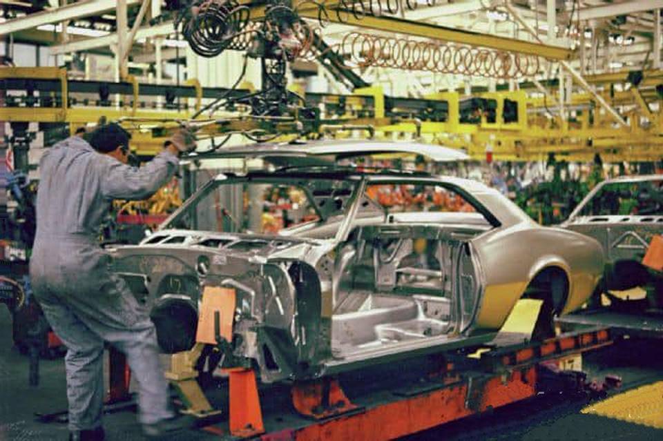

Very good read:
http://www.camaros.org/assemblyprocess.shtml#fisher
Yes, the completed engine and transmission were sent from the Engine Dress Line to the Chassis Line for installation in the subframe. The completed subframe and chassis components were sent to the Final Line for installation to the body.
Yes, the cowl tag was already on the car. It was installed at Fisher Body during the body framing operation.
The car assembly was like clockwork. Fisher Body did their part in 2 days, Chevrolet took 1.5 days for their part....a completed Camaro in 3.5 days. Pretty cool!
