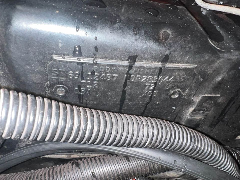

Curious as to why the body sequence number on a 05A (May) trim tag on a X66 car is in line with a 03 (March) build. Out of the norm for a RPO car IMO. Were any COPO's built in May with a X66 code? If not, why the hold up on final production? L89 car maybe? Posting trim tag for the experts to validate.

12487?
Repro tag.

I see the "8" now. Sad, nice looking car. Car is for sale on FB MKTP.

Not even a good fake. Probably put on before 2007.

Definite repop tag.
