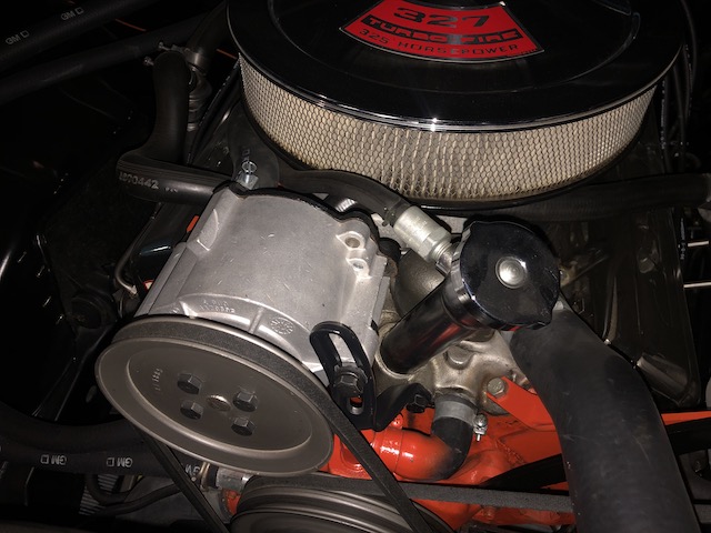

Engine is coming together. I used adapters to mount the non-center bolt valve covers. The car has the correct 62 340 horse intake and dual point distributor, along with the higher redline tach. I think the original 327 is on the barn where the car was and waiting on numbers to verify. Center rear section doesn't decode to a 62 Corvette though.
