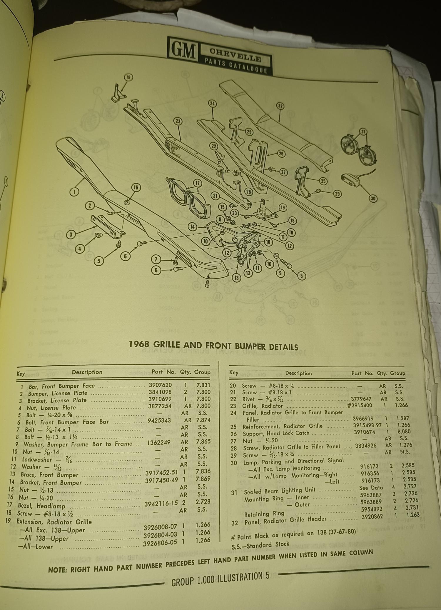

Default chevelle question
on a 68 chevelle is there 2 or 4 brackets to mount the grill I have 2 larger ones but was told there are 2 more not sure what they look like
