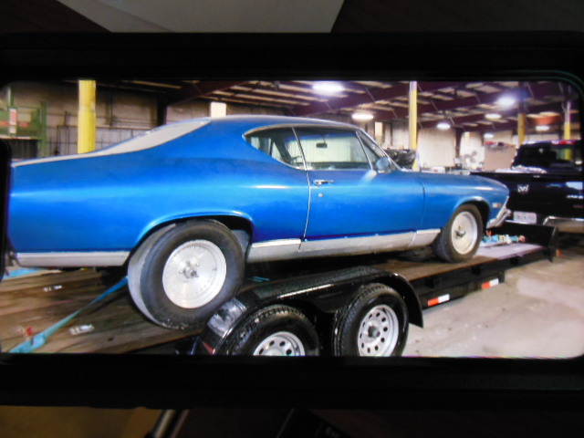

going back all stock original I guess we can try to remove the spacers and see if the car will have a better level stance this is how the car looked before taking it all apart for its restoration

Yep, all jacked up for tires and appearance. Removing the risers will drop it the same amount and it may sit too low then. New springs to correct that are cheap and readily available, once you get to that point...
