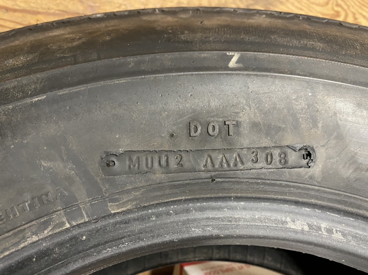

Hi folks,
Would someone please let me know when this reproduction Polyglas tire was made?
Thanks!

I believe it's the 30th week of either 1988 or 1998 (308)
As of 2000 date codes went to 4 digits. Prior to that it's 3 digits. The first two denote the week. The third is the year.

Thanks, Lee. That's older than I thought, must have been older stock when the previous owner bought them "new."
