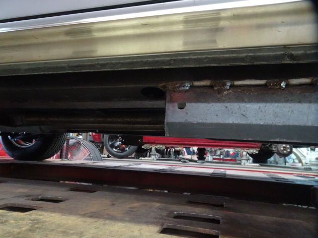

I just came across these pics I took last summer. Guy bought this GTO and it had a pull to one side. He had it to 2 other alignment shops that couldn't fix it. He brought to Centerline and once the alignment tech brought up the readings, he knew it, most likely, had a diamond. So, on the rack it went for measurement and sure enough. The last pic is what happens to a freshly painted frame that isn't checked/straightened before restoration...
